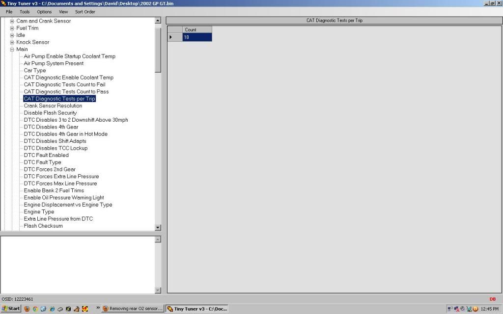

    Use DHP.
    Pull your bin.
    Open it with tiny tuner.
    Remove cat test.
    Save.
    Reload.
    HPT users are less likely able to do this
  8. #148 Re: Removing rear O2 sensor on 01-newer PCMs -- Things you should know
    Minnesota
    1,409
    How to do it depends on the OSID....I know the file I am using there is actually and option that says "O2 Sensor B2S1 Present" but some OSIDs don't have that option and have to mess with the test. If you read the first pages of this thread is tells you how to do it.
  9. #149
    Buffalo
    3,868
    If you want, I guess I could take a screen shot of tiny tuner where it says "cat test". And of course you also remove the code

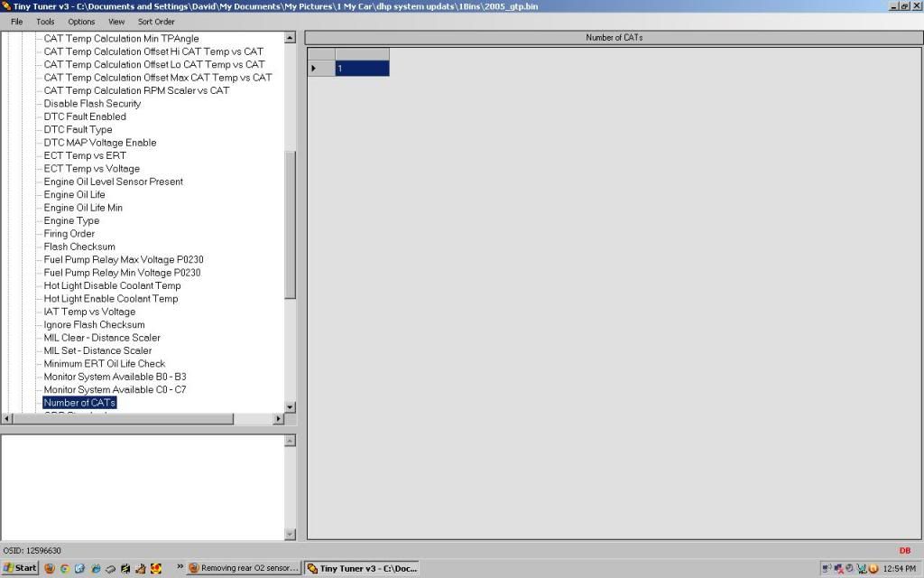

    since no one posted a pic of it here ya all go.
    also i was looking at a 2005 GTP so i could show a diff OSID had it and guess what... it doesnt... but what i have highlighted might work... if we set the number of cats to 0 my guess is it wont run the tests.....
