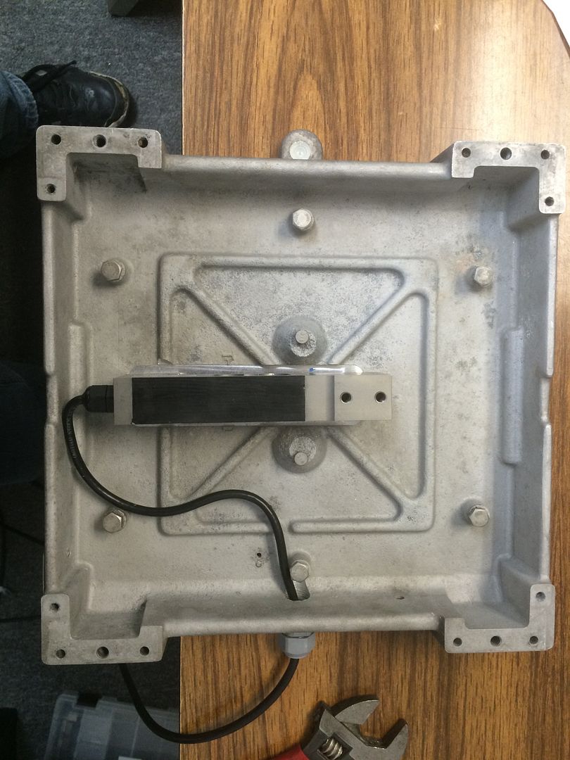

    Tapping and plugging is the way to go it's easy. Trying to weld an aluminum intake of unknown metallurgy is asking for it to crack, even if you preheat it and properly cool it. Trust me on tapping I just had to change a 1/4 NPT to 3/8" NPT and it took me all of 5 minutes.
    where the cable comes out in the picture, we only had 3/8" cord grips so that's where it was drilled and retapped.
    Jeff

    what size drill did you use to bore the hole out for the 3/8" npt tap?

    Well, I think I used a 27 or 29/64", but it's really not that important. You want to look at where you want the bushing to set. Then use a drill smaller than that diameter. Since its tapered you can have it go in and stop within a few threads, or go all the way to the base. But if you go with the minimum size you have to ream a lot more metal out. I don't keep track I just grab a drill bit that's just larger than the tip, at the first few real threads on the tap.
    The chart calls for a 37/64" (.578", or little bigger than 5/8") for 3/8" pipe and for 1/4" 7/16".
