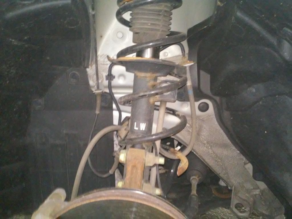

    On my mom's car (2011 Nissan Versa Hatch). She said she hit a pothole last week and it's been making a clunking noise when she turns the wheel. The driver's side wheel well was about half an inch from rubbing the tire, so I jacked it up and this is what I saw.
    I know sometimes the spring will break overtime but I've never seen it jump off of the strut. I got a spring compressor from Autozone so I'll be tearing into it tomorrow.

    I checked the VIN and no recalls. I'll call a dealership tomorrow just to confirm.
    If not I'll just take it apart and reinstall everything. The spring isn't broken so I'll just re use it.

    It sure does look broken on the bottom to me, see where it's all rusted.

    Yeah you're right. I'm reading on NHTSA's site that this has happened to a bunch of other people too. Looks like I'll be replacing some stuff.

    Wow that is crazy, lucky it didn't damage anything else like the brake line it seems to be sitting on.
    The complete strut setup looks fine, especially for that price.

    Yeah I know. A lot of people who filed complaints online said the spring shredded their tire when it broke. There definitely should be a recall on this.
