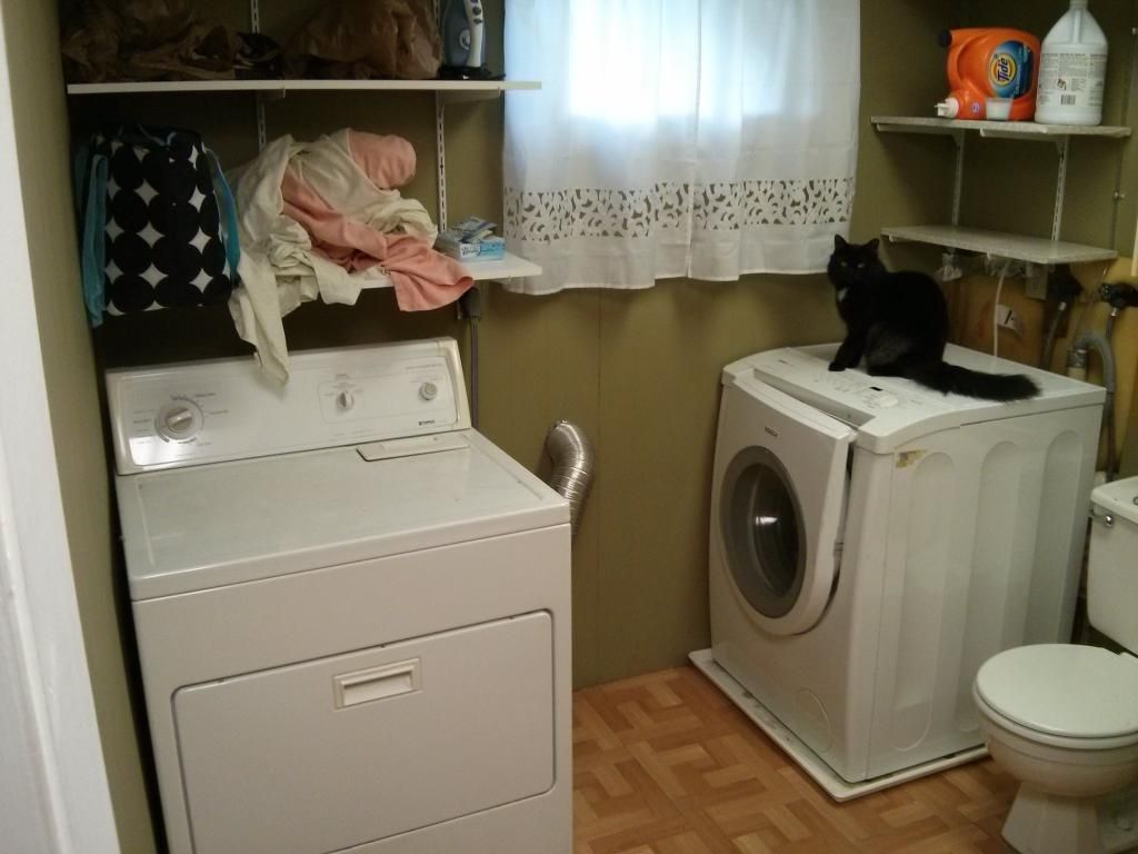

    I got some work to do in this room but it should be awesome once done. I'm adding more storage in the room, it was going to be a shower stall...but plumbing was turning into a nightmare.

    It is one of the very first front loaders
