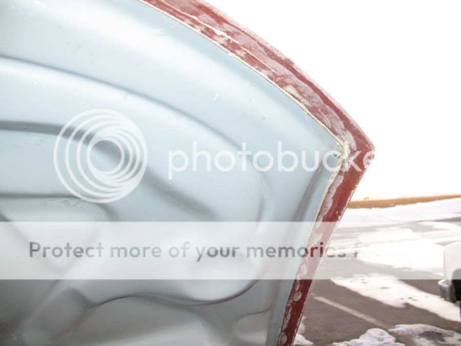

    I had a stinger/ascd slp hood. I can say the underside is very ugly.
    Here is a pic of the seams around the hood where the topside and bottom side of thefiberglass halves was glued together... prety ugly. will really look bad painted IMO...

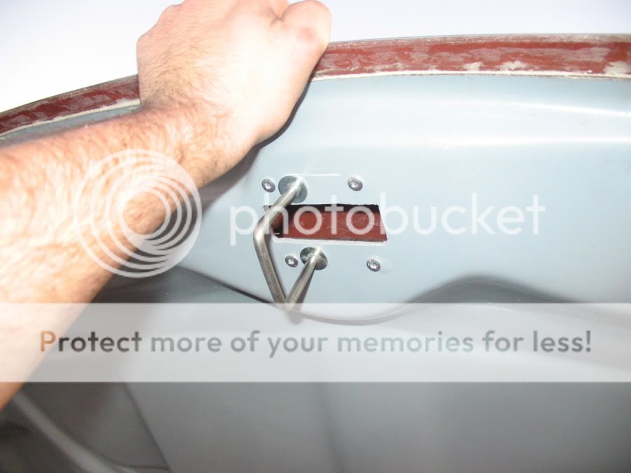

    Hood latch needed a TON of working of the striker aswell as the latch asembley on the car, I ended up heating the latch up and bending the **** out of the striker forward. The latch system is a little weak where it attaches to the hood. It is bolted by 4 bolts with a small little metal shim on the indside. You may want to consider hood pins.
    Lastly the originally completely forgot to give me the brackets so I could mount the struts to the hood. So I ended up making my own... which is why I was holding the hood up in the pics.

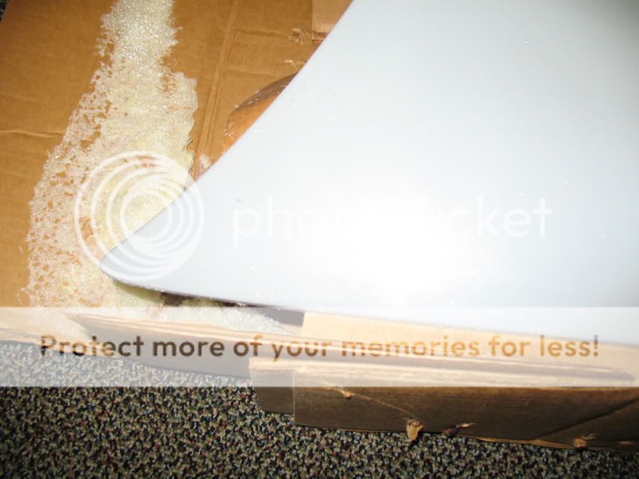

    it was around $130 to wyoming. it comes in a box with the only protection being great stuff expanding foam around the corners (have fun cleaning that crap off) so definatly remember to check the hood (inside the box) before paying and signing the paperwork.
