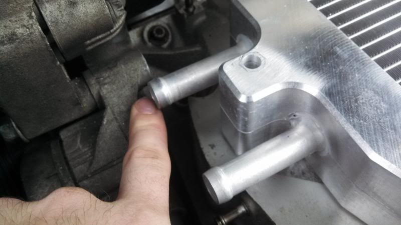

    Got started on the intercooler install. Pulled the blower off, pulled the LIM and valve covers. Everything is getting repainted. The clearcoat yellowed really badly on the SC housing, so time for another color.
    Got the LIM all opened up and stuff. Currently removing the H bar on the Gen V, filling the silencer ports, and epoxying the EGR hole/divot.
    Also messing around with coil pack relocation, hose routing, and clearances.
    Phone doesn't quite capture the difference in color between the case/snout/TB.

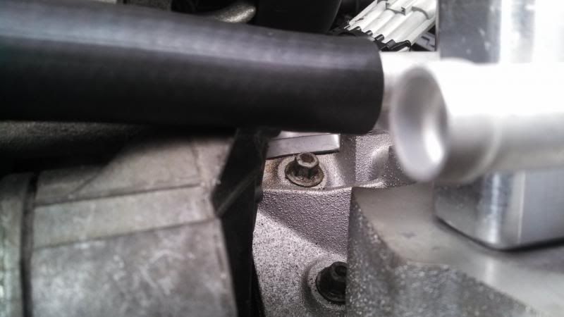

    Made me giggle with excitement. Got it on to see how much clearance I had between the IC core barbs and the Alt bracket. Should be just enough to work.
    For size reference.
    5/8 hose fits well enough without trimming the bracket. Though I may still.

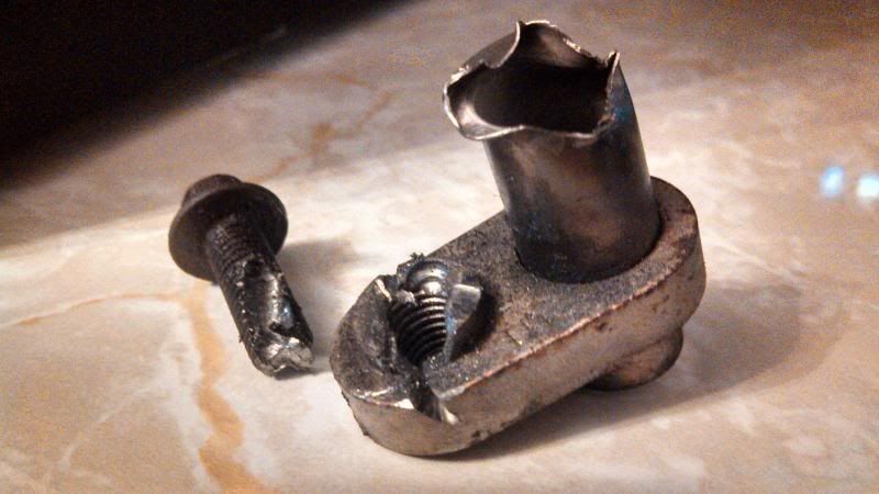

    EGR bolt decided to be a *****.
    Once 1/3 of the threads were drilled out, it unscrewed like it wanted actually wanted to be removed.
