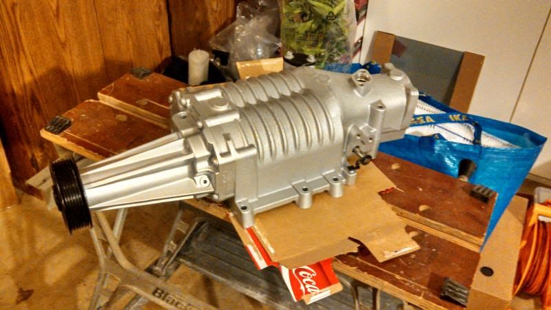

    Nothing much, but did decide on a color for the blower.

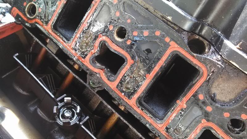

    Got crackin on the whole removing **** part

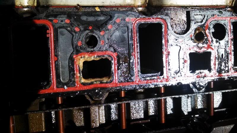

    and a good reason to always change out the factory LIM gaskets to the metal revision

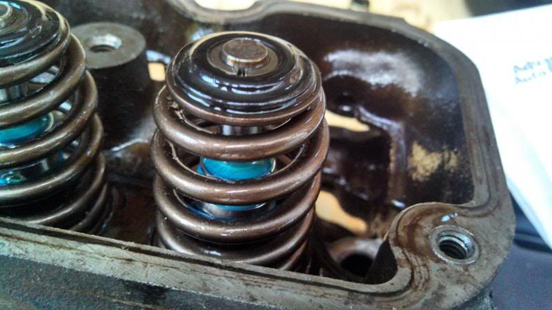

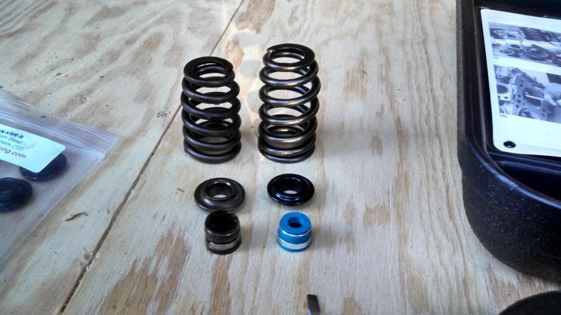

    Got the 105's on, retainers, and new seals. Head wasn't cleaned up yet. It's since been degreased, painted, and oiled.
    quick little before/after shot thingy

    You sure that those are the stock LIM gaskets? Both of my engines had grey rubber seals. That, and your's don't look too bad, don't get me wrong, they needed to be replaced, but the few I have seen looked WAY worse.

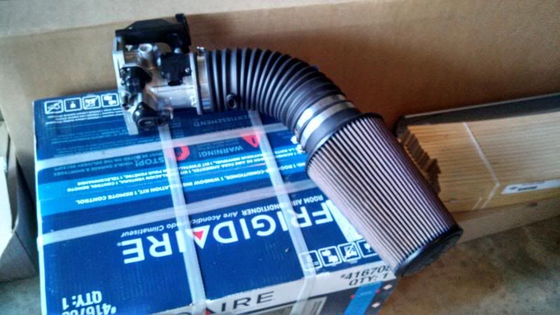

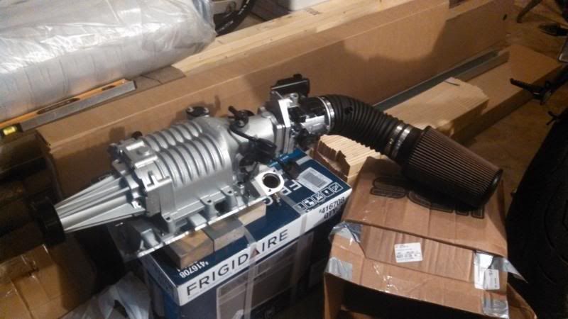

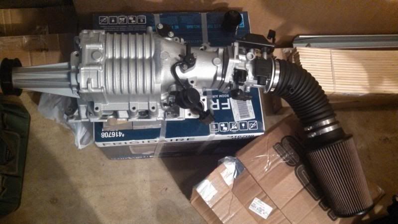

    Opened up the LIM to match the Gen V outlet, opened up the coolant end cap area too, but no pics. Need to plug the coolant ports to the S/C tomorrow.
    Got the TB all painted and put back together. Used some 1000 grit to smooth out the inside of the TB except for where the blade sits. Still need to drill and tap the plug for the EVAP stuff.
    And just for ****s and giggles I did a impromptu mock up. Yes the TB adapter is loose.
    Lighting was **** in the last 2 pictures so everything looks much darker and 'grayer' than it actually is.

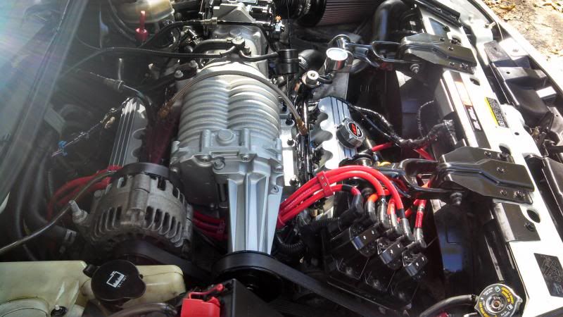

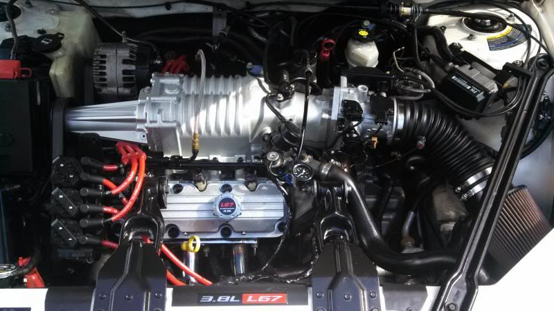

    Had a family emergency that has required my attention for the last month. Due to said emergency the car had to be slapped back together before the cam went it (insert sadface here)
    This is right after everything got hooked back up and running. Nothing was routed out of the way or tucked any.

    Gen V definitely whines more than the Gen III. I'm getting right at 8.5lbs of boost with the 3.8pulley, intake, and headers. Stock tune with the Gen V is showing 2-3* of knock around 4400-5200rpm in 2nd, and a blip of knock right before the shift from first to 2nd. Plans are to get the cam in, drop to a 3.4 and tune it.
