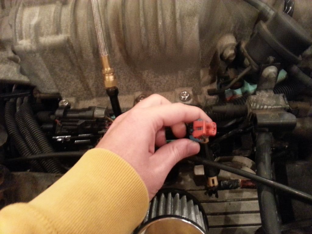

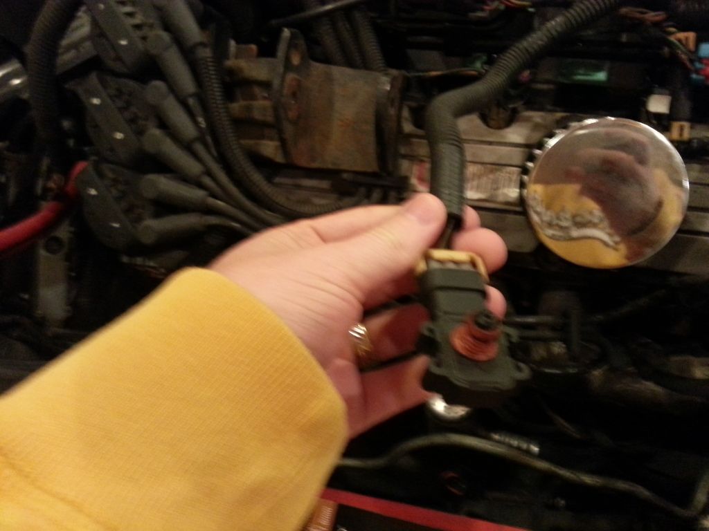

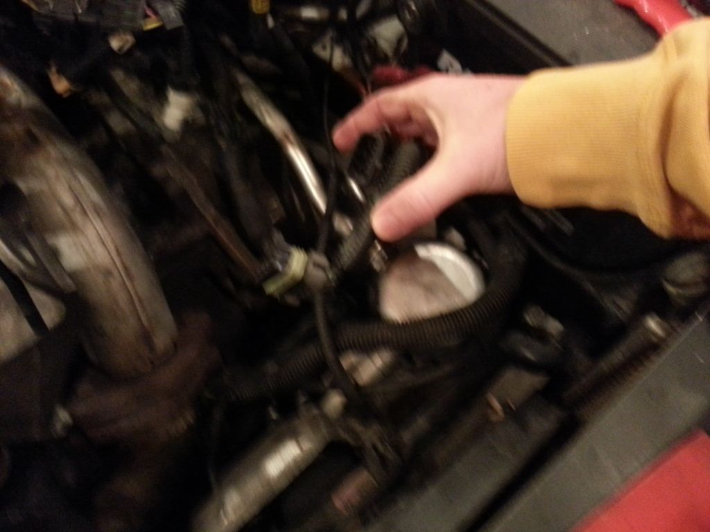

    Everything I have left to do requires a trip to the parts store, I have my shopping list for the day, so i'll leave some pictures of sensors that I need a home for.
    Coolant hose attachments I need for 99+ alt bracket. This is my 98:
    Sensors:
    I'm guessing this one is not used, and I wire in the BBV here.

    so the first pic of connectors is the l36 map sensor, that doesnt get used you need to wire in the l67 sensor. the second one im not sure what that goes to maybe an emissions sensor, but yes the bbv will be that same style connector that you need there. the 3rd pic is the icm connector, the icm/crank sensor harness will plug into that with the main engine harness.
    No more GP 04 Impala SS Indy:

    Connect remaining wireharness sensors, I have ONE unknown see post 49 pic 3, 3 pin connector i am holding

    isn't the evap vent solenoids connector red?
