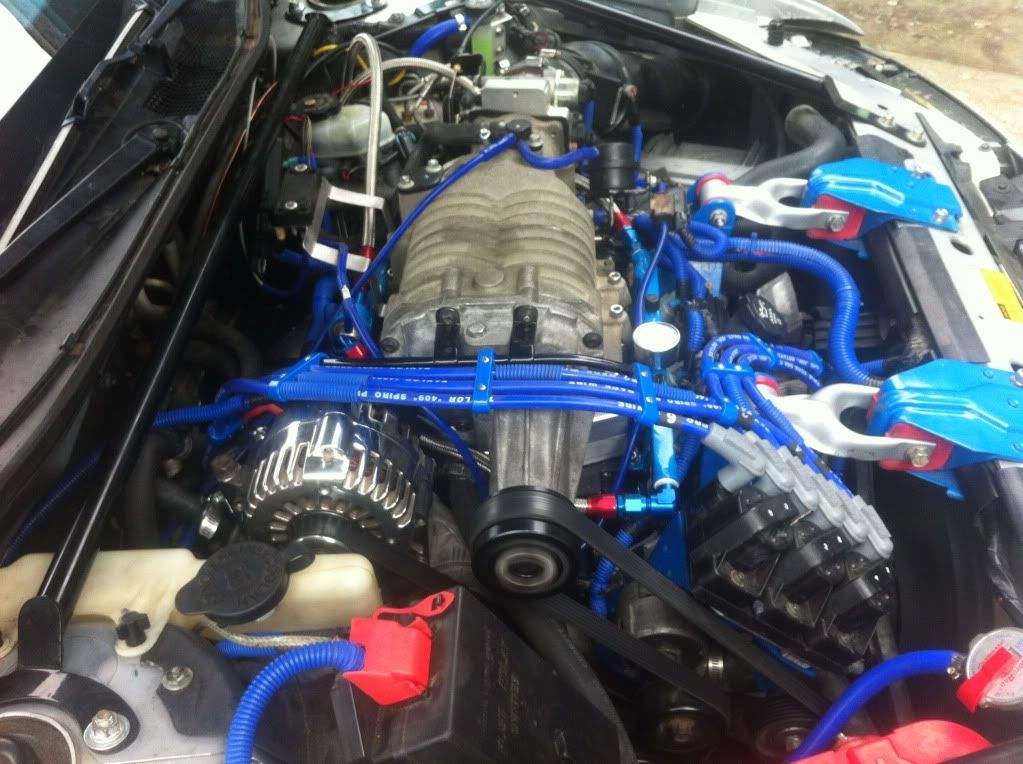

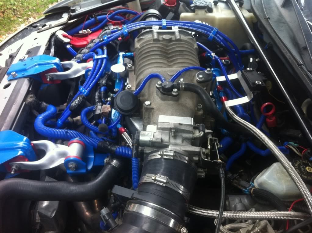

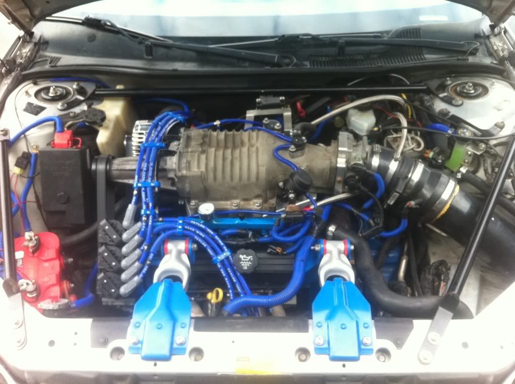

Don't think I posted any pics of the engine bay after I installed the motor yet...
http://i1236.photobucket.com/albums/...s/IMG_2798.jpg
http://i1236.photobucket.com/albums/...s/IMG_2797.jpg
http://i1236.photobucket.com/albums/...s/IMG_2799.jpg

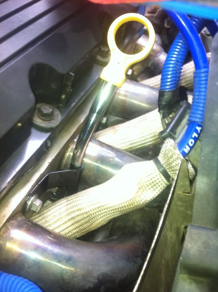

Polished the top few inches of my oil dipstick just cause I was bored.
http://i1236.photobucket.com/albums/...s/IMG_2801.jpg

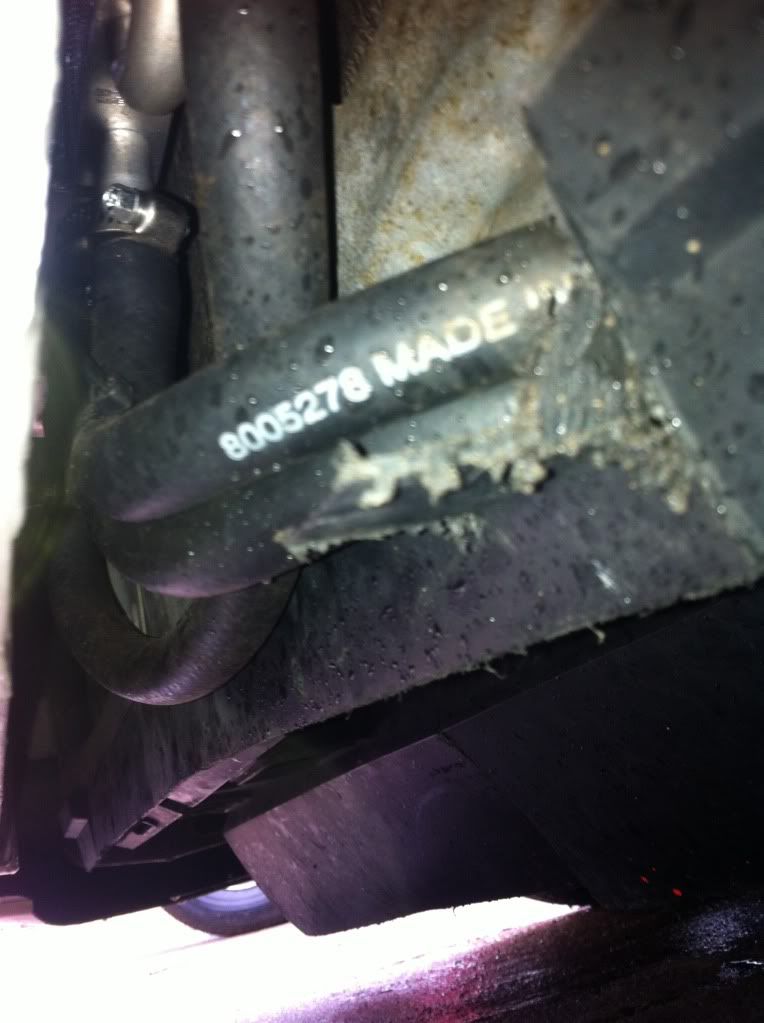

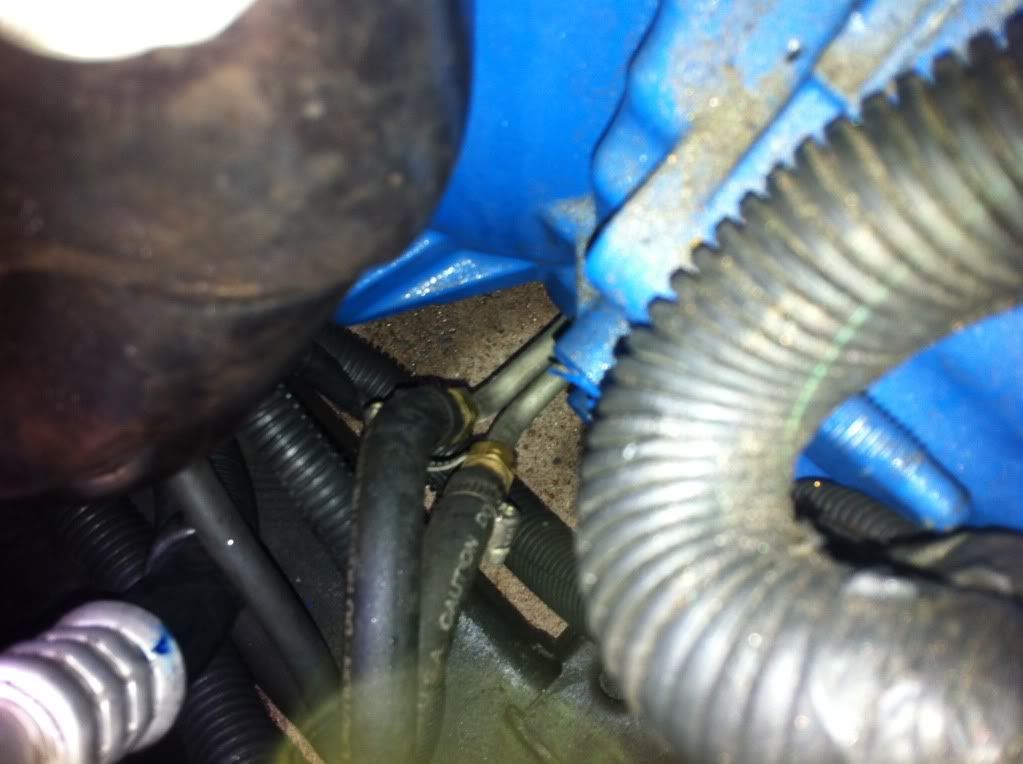

And these are the best pics I can get of my trans lines without jacking it up, and it's raining so I'm not laying in the driveway lol
People who had it before me had the trans rebuilt and the shop put those fittings on. Just compression on one side and barbed on the other.

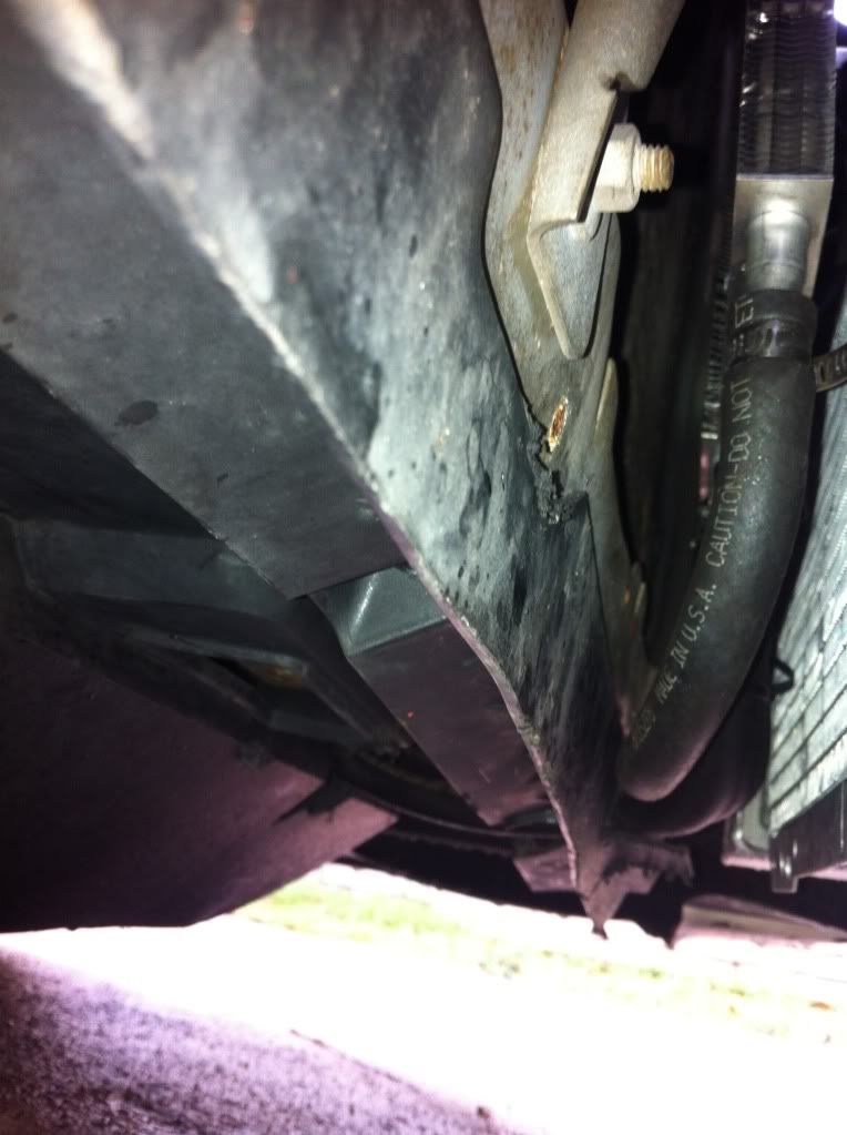

I cut up that plastic piece and now it holds the lines up and outta the way
http://i1236.photobucket.com/albums/...s/IMG_2979.jpg
All hidden...
http://i1236.photobucket.com/albums/...s/IMG_2978.jpg
Don't make fun of my crude MS Paint picture but here's how they are ran if you can't tell from the crappy pics. I know I shoulda put the feed and return lines as far appart as possible but it was a bit much of a radius for the rubber line and I didn't wanna chance a kink or flow restriction. Plus the way I cut that plastic it was way easier to hook the lines up right next to each other instead of far apart. And besides with 32,000lb total GVW rating I think it will be fine, I'm more worried about it being too cold. You can be sure by next winter I'll have a tstat setup on it.
http://i1236.photobucket.com/albums/...ross/tcool.jpg

The rubber will rub on the plastic and wear through it.
Get wire loom to wrap around the rubber where it touches the plastic.
Your ECT's might not be good this summer. looks like the most important section of the shrouding is gone.

I've had the lines ran like that for over a year now and when I pulled it all to install these there was no wear. I purposely cut the plastic piece so it wasn't deep enough for the lines so it would apply just a little pressure to hold them in place.
matt5112
I have plans in the works with my dad who is a stainless fabricator by trade, to have a piece of 14 or 16 gauge stainless cut that I will attach to the very bottom lip of the bumper and probably somewhere on the subframe. Then cut angled vents to pull air into the radiator kinda like the pic below but upside down to scoop the air. Pretty sure he said they have those stamps or bigger with their press at the shop so should be easy enough if I just make him a template outta cardboard.

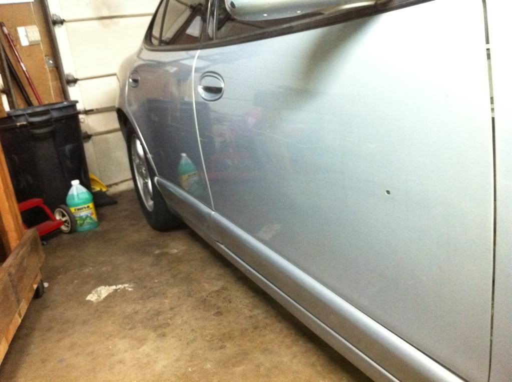

Passenger rear handle installed on the front finally. I thought they were direct drop in replacements, NOT TRUE!
So what is the difference? I've considered replacing the passenger side front to get rid of the lock on that side, but what should I expect???

I like the lock delete. Would suggest running the plug wires under the charger snout.

I had to take the pin out of the one side of the new handle, and the old handle and remove the metal arm on my origional and put it on the new one and reinsert/flare the pin. Not a big deal, but it did take me a minute to figure out the new ones weren't direct bolt ins.
And not use my pretty guide rail I made??? Blasphemy! But seriously is there a feedback issue or something? They still reach the back just fine and any place they could contact anything I have wire loom around the actual plug wire.

Hood clearance doesnt exist.
Re: 98 GTP progress/build thread PIC HEAVY!!!! Updated SE panels, LED int. kit, gauge
matt5112
Maybe the craddle spacers I have or the guide rail I made but they don't contact anywhere... I don't run a hood liner either and I'd sooner cut hood braces than move them I think. Weight reduction FTW, who needs bracing?
