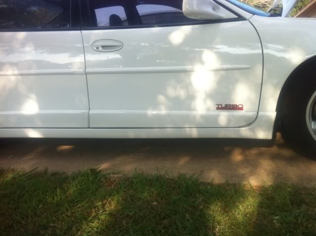

Turbo badges on:
http://i233.photobucket.com/albums/e...x/46af463b.jpg
http://i233.photobucket.com/albums/e...x/c284d932.jpg
Looks like I might need to paint the calipers red. My show sign has red lettering for GTP so it matches nicely.
Well no go on the Supra. They want to run next week. Did catch a newer Mustang with exhaust and Idk what else on the way home and ended up racing 3 times. On the third race from a 50 punch I gave him the hit and he pulled pretty good. Reeled him in and passed him. Slowed down and he caught back up. He had a big grin and his face gave the thumbs up and shouted. I dig the car man. Shouted back thanks for the races and went our separate ways. I'll update next week after I race the Supra.
Dude I've got to say this is what of the best GP's I've ever seen awesome car man
i say take the turbo badges off, keep it clean. Or at least raise them up to were normal GTP badges sit. Stock badges dont sit that low to the rocker panels i dont think.
I've driven the car for 2 years with no badges. I'm wanting to change the look up, and it's hard for me to get a race, where as the turbo badges help sucker people in to racing. I did almost put them where the factory GTP badges were, but opted not to because I wanted it to be a little different than every other GTP out there. You are correct thought the GTP badges are about 6" from the bottom and 6.5" away from the seam of the door.
