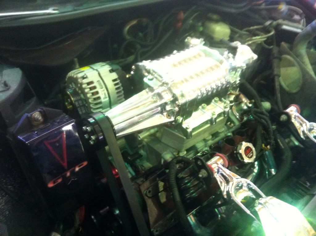

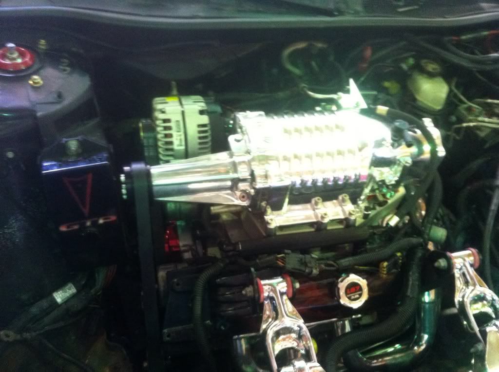

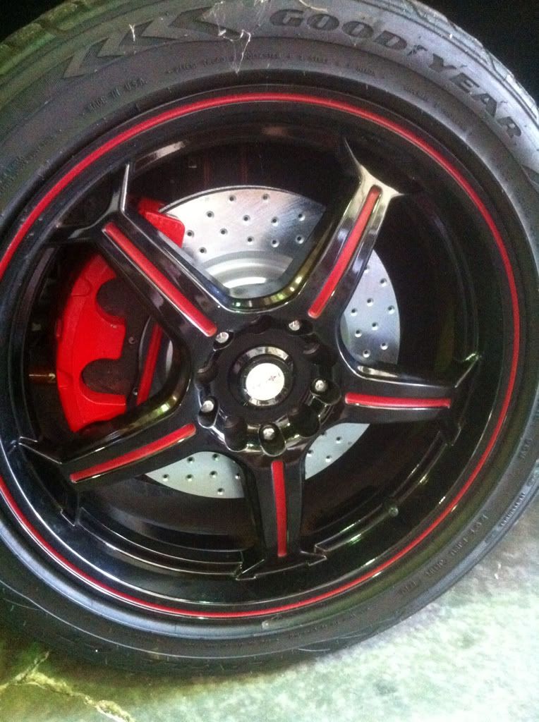

Spartan put in some serious work today. Alas... i have class in an hour and a half so finishing is postponed untill Thursday
Intercooler Permatex 26B onto the LIM
GEN V glued to the intercooler.
PRJ Fuel rails installed today
Both belts on after a few hicups.
Front Brakes finished
http://i917.photobucket.com/albums/a...l/04ea578f.jpg
http://i917.photobucket.com/albums/a...l/4e8e6229.jpg
http://i917.photobucket.com/albums/a...l/da7a3859.jpg
Issue:
I'm missing my stock Fuel pressure regulator and am in need of another one.
Supercharger belt hitting coil pack bracket (Searching for longer bolts so i can put a few washers to raise it up a notch.
Re: Spartan GL's Build Thread: (6-12-2012) PG 42 Fuel Rails/everything bolted up

BillBoost37
Thanks.
Another issue i am having with raising the supercharger due to the intercooler is the Supercharger belt hitting the coilpack bracket.
Those three litte flat edge square screws if i can find them alittle longer i can ad a washer to fix the issue but i can't seem to find anything like that locally.
Ideas?

I found them to be too short. Others say they can space it.. I say Bonnevilles rule.
http://i20.photobucket.com/albums/b2...s/IMG_4372.jpg
http://i20.photobucket.com/albums/b2...s/IMG_4368.jpg
Marchi found some flat round headed bolts that were longer at a hardware store and all we did was cut them square and they fit the bill nicely. but it's a matter of looking at the hardware store and getting lucky.

Ordered a new Fuel Pressure Regulator (old one is MIA most likely got taken with my old fuel rails.)
Got 6 feet of 3quarter heater hose and 2 3 quarter to 5/8 adapters for the Bonneville alt bracket.
Bunch of Hose clamps, and some gasket paper so i can make a N* TB gasket.
other then that all that is left is to bolt up the Throttle Body/Cold Air intake, Mount the FMHE and route those hoses. reconnect the battery and bam. car is on the road again.
sadly i won't be able to get to it till Tuesday morning/Afternoon.
