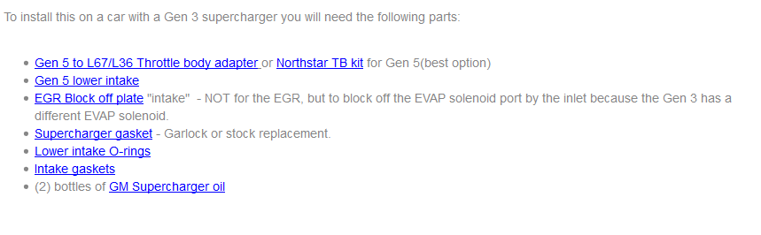

Anything else I would need for a gen v swap?
