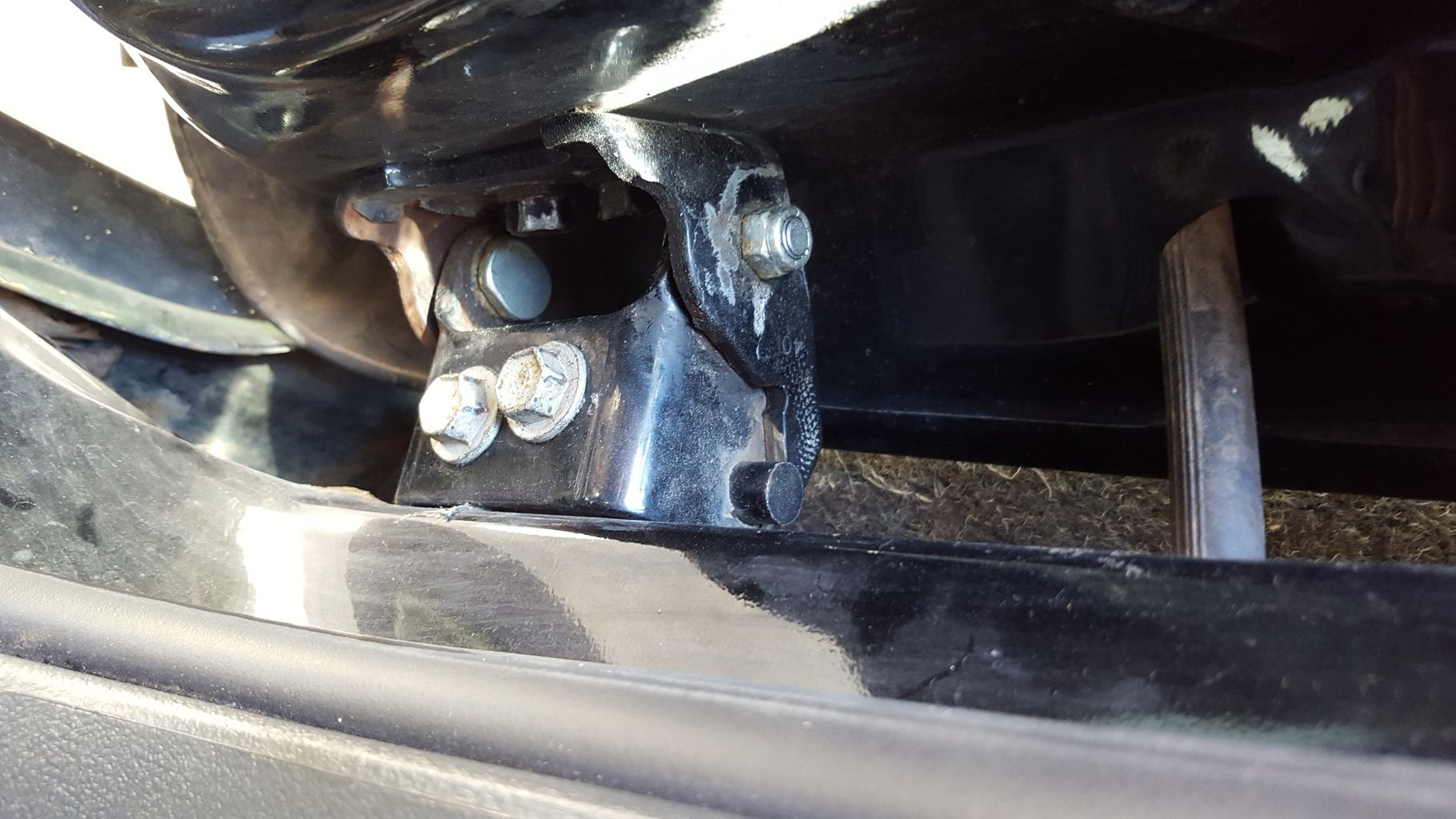

    Before door. Notice pins aka the only thing that dont look like bolt heads. 2 per hinge/4 per door

    Better look at the hinges with door gone
    Untitled by smetters20, on Flickr
    I actually took the ENTIRE hinge off, door first then car. While looking at the hinges I realized there was absolutely NO need for this. 2 bolts right there dead center looking at you are all that need to be removed. I wasnt sure hence why I took it off first. But the 2 bolts can be removed leaving this behind on the body
