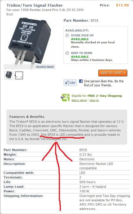

    Quote Originally Posted by squeeze View Post
    Now w/LEDs you will need a Resistor which i still havent gotten but all i have is hyperflash for now on mine.
    You can just buy the electronic flasher... Unplug the old and plug in the new up under the dash by the e-brake pedal. I can't recall the part number but autozone has them on the shelf by the electrical connectors. Just take your old one in and match it up if you can't find the number. And why the hell didn't you show us these last night??? I remember you mentioned them but I forgot to look...

    This one...

    As far as the lights go I forgot to show them to you, what can I say my mind was elsewhere Hahah I'm gonna have to try that flasher out because mine hyperflash which I don't mind too bad but I do like the normal
