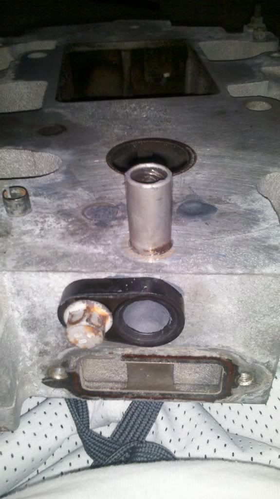

    2. When filling the holes try to put some sort of pressure on the oppisite side, so it is flat and come lose. (if you would lik this is a great time to fill in the EGR with this stuff then put the bolt and holder in place)
    3. Let dry for about 3 hours, then LIGHTLY sand the highs spots down smooth with the top of the LIM, I used 80 grit

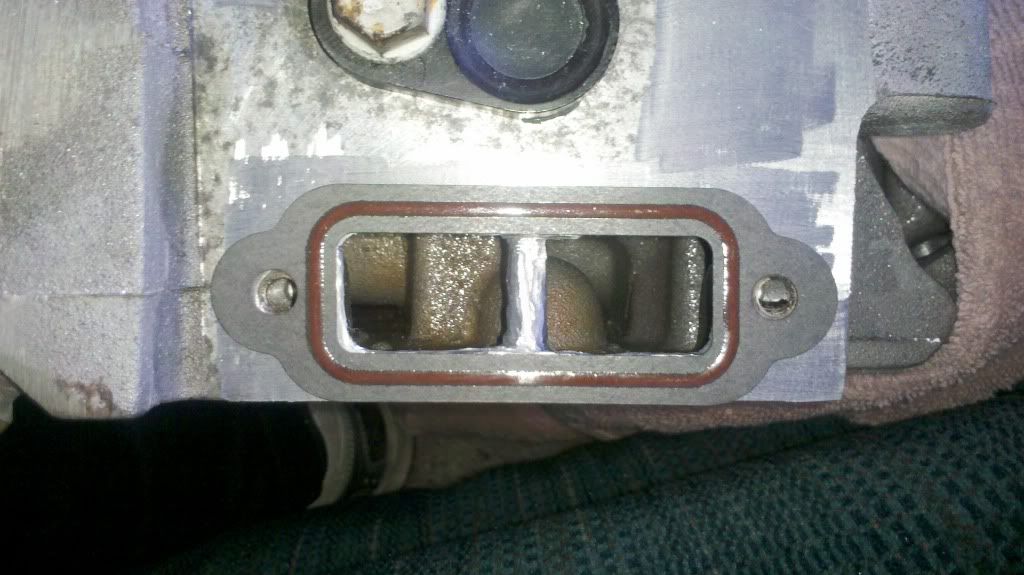

    4. Take of the coolant cover on the drivers side of the LIM
    5. You will now want to take a dremel with the bit 199
    6. You will now want to take ur time, and take the center divider out, to the middle.

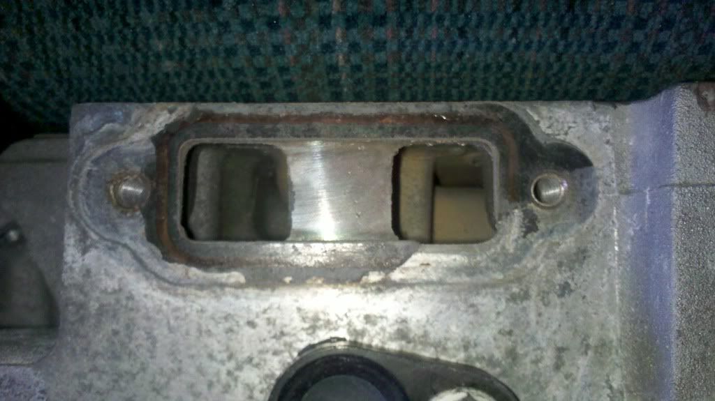

    Before:
    After:
