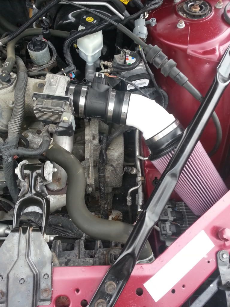

    Alright so a lot of people ask how to make an intake. I've only seen the fender well intake method which is pretty hard for a common person. I decided to outline how I went about doing mine. Which wasn't too hard at all.
    This is my intake:
    So it's pretty simple. Go to your local Autozone or Advanced Auto Parts and get yourself a 4" intake which is commonly what they have in stock. I got the longer of the two choices just cause it's more balla.

    Now the issue people have with the pcm is pretty simple. People always ask what to do with it. People have said you can just leave it on the metal support under it and zip tie it down, what I like to do is cut up my stock intake box and use the pcm tray that was originally there:
    Now when you connect everything, it should be nice and tight:
    There is just enough clearance for the filter not to hit the cross brace or pcm. But I've had my intake hit the pcm, it's not to big of a problem:
    And that should be it! Hopefully this wasn't too hard to follow. Go out and enjoy your new intake! Any questions, feel free to ask!
