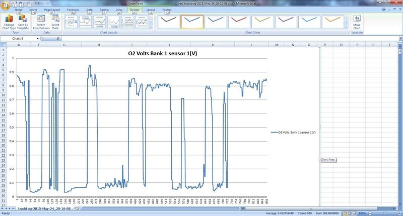

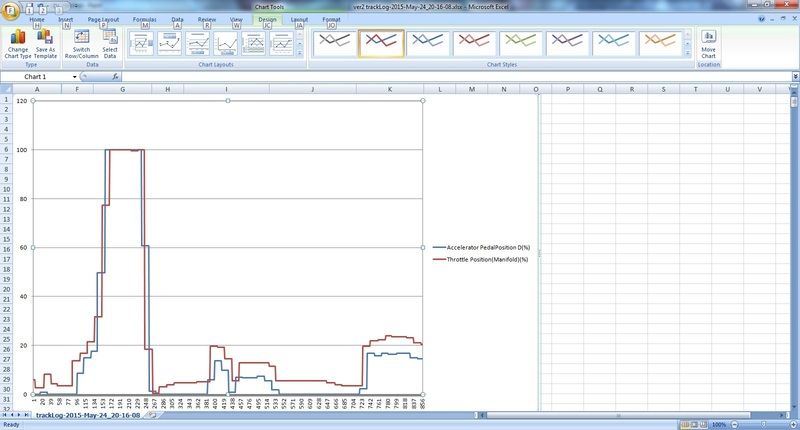

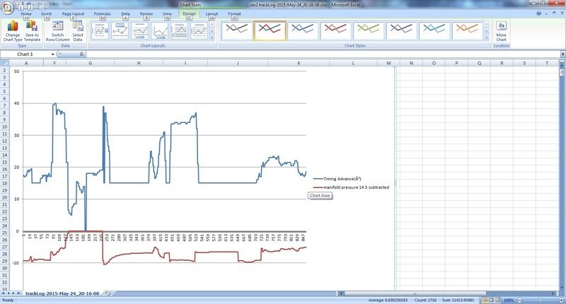

    Oh man I'll have to do that after hours at my work. Lol. Here's the graph from 1run.
