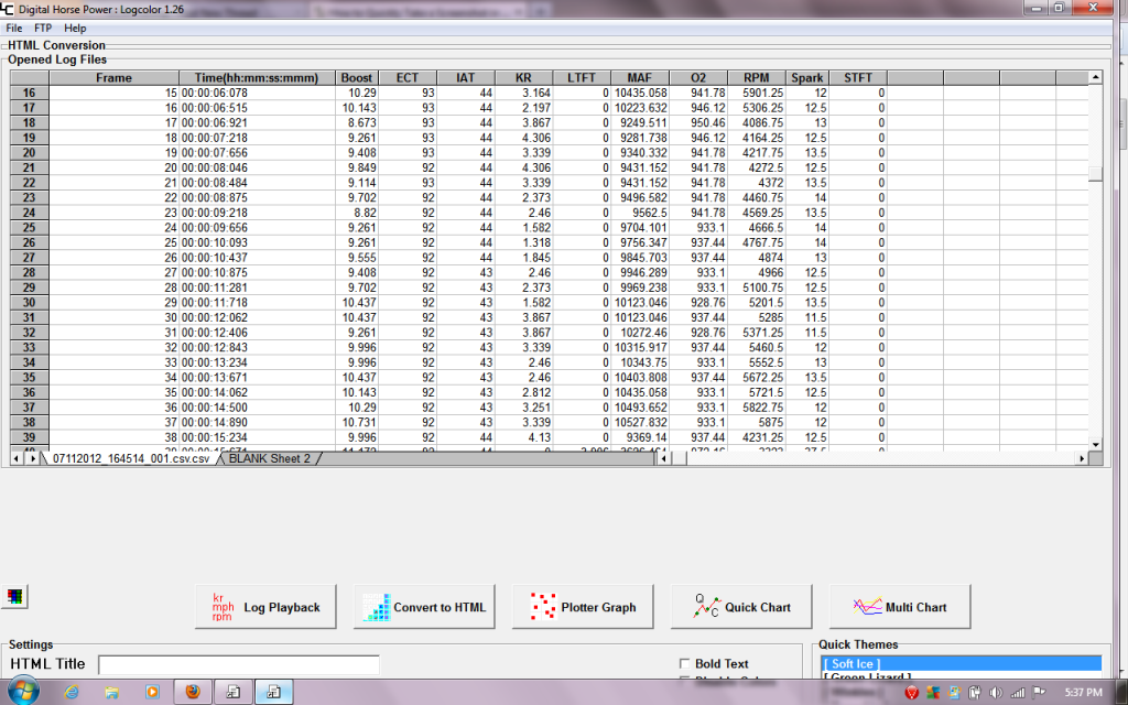

    I'm not sure what to change to lean my car out a little bit. Here is a log and my wb shows about 10.8 ish at wot

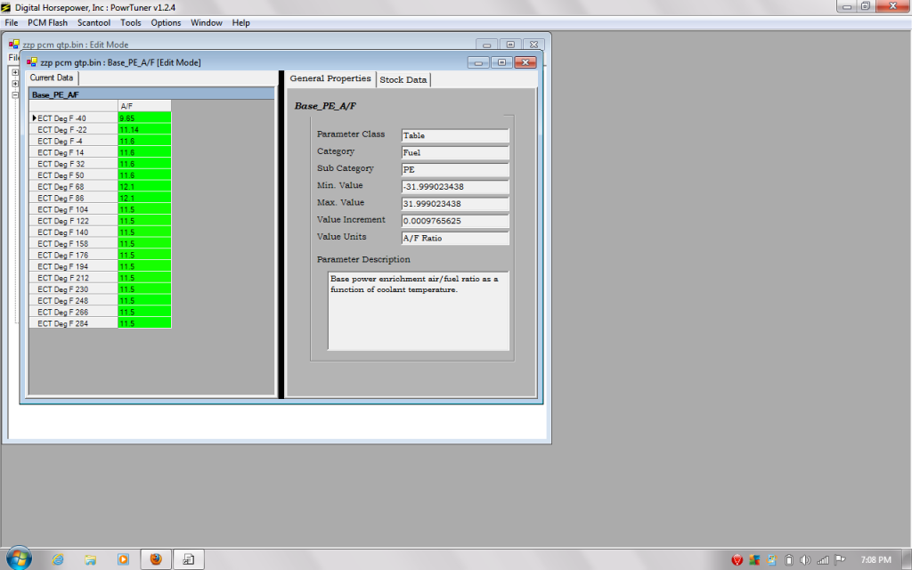

    Show a screen shot of your: Calibration data>Fuel>PE>Base_PE_AF
    That would be where the main changes would be made but before you do anything post a screen shot.
    10.8 is pretty solid for a 3.4 car.. but I would wiggle PE up and down to see if the KR gets worse or better... leaner is probably not going to be the direction you want to head.
