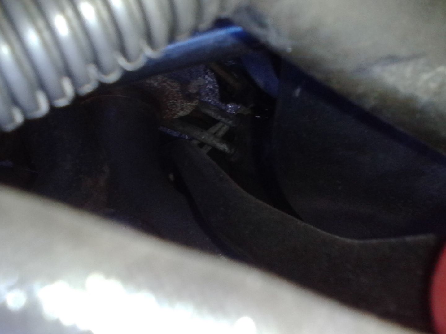

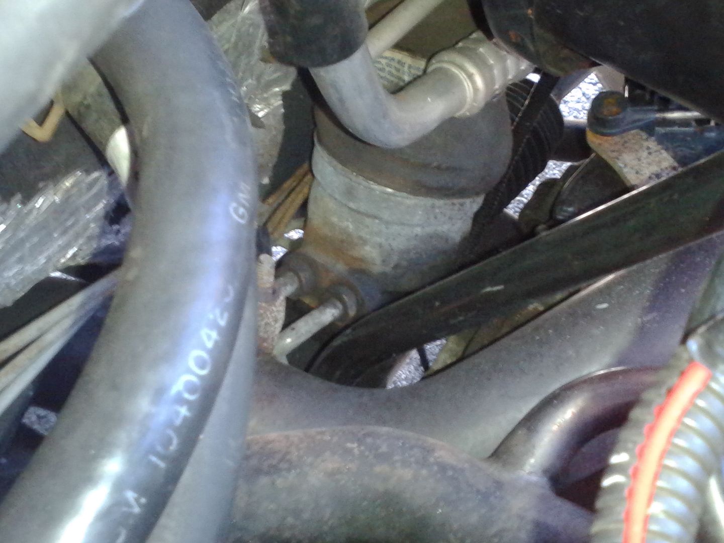

    not sure your year, but you may need a older style tube. my 98 tube was just resting on the cross over. i bent it in the car off the pipe just a bit.
    looking down the tube from the top.
    pass side rear looking to the tube.
