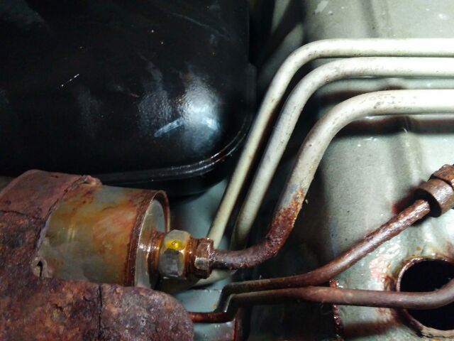

    As the title states. I need advice on budging rusty fuel filter that is clogged on rusty 2000 Bonneville. Soaked the line nut in pb blast for two nights prior to removal attempt. Got under the car and was unable to even budge it. being a fuel line obviously I couldn't hit it with heat to soften the metal. Any advice on removing the filter would be appreciated.

    vise grip in the line nut, hold the line nut still, and then use a another wrench to turn the filter off the nut.
    dont turn the line nut or the line will twist and then your patching it up for sure.
    ^^^THIS.

    Tried that. It wouldn't budge.

    I second the motion, do what Scotty says, worked for me on several rusty/stuck filters. If you need more leverage, find a way to cheat. Wear thick gloves. Put the force of GAWD on that nut.

    It'll come off. Sounds like you need more leverage than the standard wrench is giving you. Keep hitting it with PB.

    The Fuel Filter in question is on my car. I only let buickman104 go at it when I got scared that I was about to break the fuel line. The only other option I thought about was using a wirebrush to clean up the nut a bit, and then hitting with PBlast.

    Couldn't hurt. Would let the PB get further into the threads.

    Only way to get an ugly one off w/o hurting the line is to turn the filter and hold the line/fitting solid. When all else fails... turning the radio up and realizing that I've tested the limits of a fuel filter is the way to go.

    Cut it off and buy a repair kit. What I did. Was just going to leave it on but just the little bit of messing with it caused a pin hole leak where it was rusted.

    Might you happen to have a link to the repair kit you used?

    They sell them at Advance. Just a 18" line with fitting for filter on one end, and a compression fitting for where you cut in. Like 18 bucks I think.
