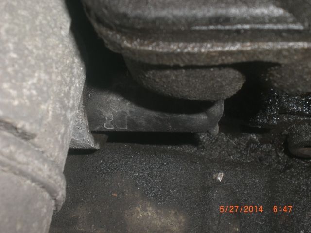

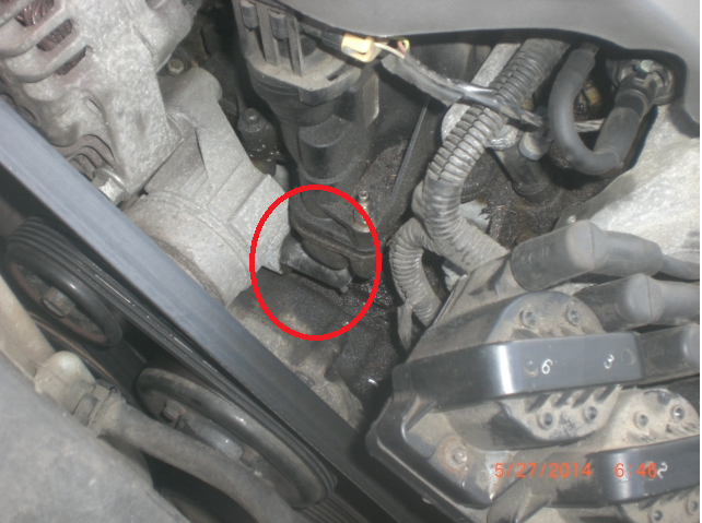

    I recently replaced brand new Spark plugs & Wires in my 2002 Pontiac Grand Prix 3.8 Liter V6 Non Supercharged car. In under 3 weeks my Low Coolant light came on. I opened my hood and noticed a hissing sound coming from a small hose hooked to the Alternator and engine. There appears to be a tiny hole in the hose that is leaking coolant. My Coolant Reservoir is completely empty. My question is this hose part of the spark plug wire or something else, and is it safe to drive without coolant, until I can pick some up. My engine is always very hot when the engine is running more then 5 minutes. Below a few pictures of the hose I am talking about. Any help would be greatly Appreciated

    Coolant elbow 47065hp

    You need to pull off the tensioner/alt bracket thing and replace the elbows with the part # smuts listed. Make sure you remove all of the elbow from the LIM and bracket. You will loose a good amount of coolant so its a good time to flush the system and refill it with green coolant then bleed the cooling system.

    Thermostat had nothing to do with it. Alternator bracket must be removed

    So I need Dorman 47065HP HVAC Heater Hose Fittings Coolant Elbows GM
    http://ecx.images-amazon.com/images/...L._SL1500_.jpg
    2002 PONTIAC GRAND PRIX GT
    "LISTEN! CAN YOU TELL THE DIFFERENCE BETWEEN
    A CAR WITH A BAD TRANSMISSION, AND ONE THAT IS POSSESSED BY A DEMON FROM HELL?"
  9. #9 Re: Unknown Hose!!!!!
    yep exactly what you need.
