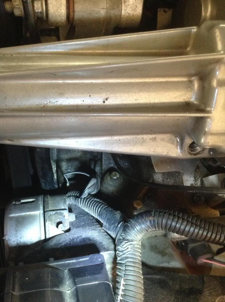

    On my 98 GTP, the SC had a black fill plug that required a torx to remove it. Well that stripped so I ordered a new one, the one they sent is gold with an Alan head wrench removal. Will it still fit?

    Dremel did nothing....I might run to auto zone and see if I can find an extractor
  11. #11 Re: Supercharger Fill Plug
    Arizona
    2,930
    You should try again with sc being hot see if that let's it crack loose I had to jam a bigger Allen head in there to take mine out.

    Car is gonna be junked cuz I can't get a damn plug out. Now metal shards will just be floating in my SC oil, just great

    We're all good! Dad saves the day by jamming a torx in with a hammer. Somehow. Haha I tried earlier but I guess he has a lucky touch! But the supercharger oil is surprisingly full. I am trying to take pics of something and put them on here. Is the best way to copy and paste a photobucket link?
