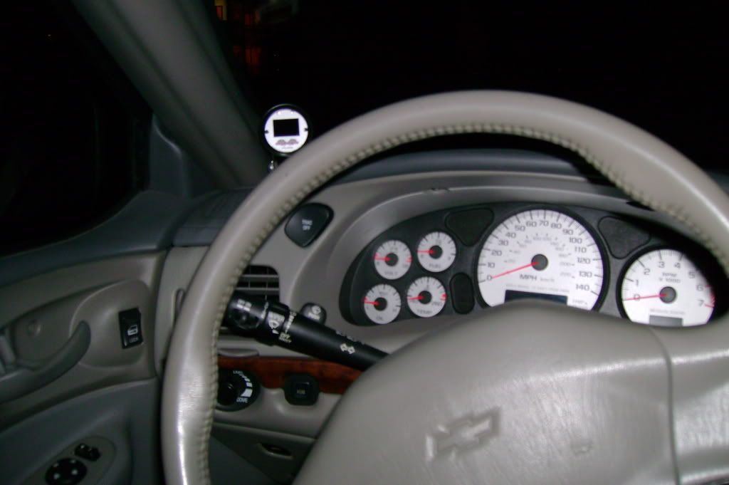

For a while I had mine in a single gauge holder on my dash:
http://img.photobucket.com/albums/v3...p/DSC02272.jpg
Once I decided on another gauge, I got my a-pillar pod and put the Aeroforce in the lowest pod.
http://img.photobucket.com/albums/v3...2/DSC02414.jpg
The difference it made in usability was huge. I couldn't believe it. So, with that in mind think long and hard about where you want it. Moving it that little bit was like getting the gauge all over again. Using it felt much more natural. I think part of it is that now I don't have to lean forward at all to touch the buttons. They're within reach without any extra body movement.
