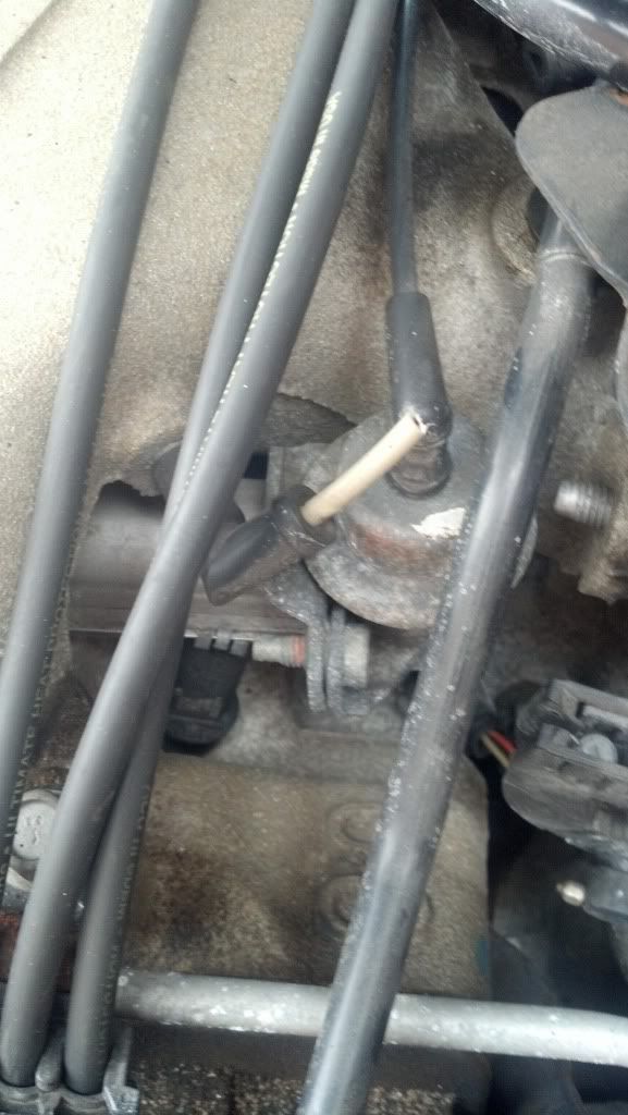

    The car has been running kinda rough, especially at idle. Already changed the Plugs and Wires but it still idles rough.
    Looking at the engine bay, I came across a broken Vac line. Which I assume must be the problem.
    The question is, where does this vacuum line lead too? I cannot seem to find the end of it so I can replace it.

    Could it go to the EVAP under the ICM/Coils or the MAP (unless I see the MAP plugged into the 1" piece directly into the side of the UIM)?

    It goes into the wiring harness right there. They all break.

    I was wondering that to.. I saw where it goes back, but couldn't make out if it went to the harness or not. I was like WTH in the harness?? LOL
    Dan, I need a plan of attack.
    How can I fix this problem?

    Open the wiring harness there right by the tb and use rubber hose to reconnect it.

    I looked at it.
    Its kinda tucked back into the wiring harness.
    Looks like a pain in the ass a bit.

    Just get to it best you can and put a rubber vacuum line on there. I did this on almost every 31/3400 I've worked on because they always break right there.

    Does Autozone carry just random vacuum tubing? And do you know what size I need?
    Also, What is that vacuum line for?
  10. #10 Re: 3400 Vac Line Question
    Not sure what it runs to but take that little piece that's left on there with you and they will have what you need. Get 3 ft to be sure you have enough.
