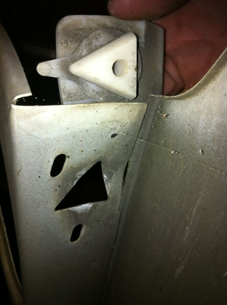

    But, we had a small issue with with the plastic triangle by the bumper. We couldn't figure out how to remove it so we broke it off. Any ideas on how to remove it?

    Plastic triangle? Are you talking about where the front bumper slides onto the fender?
  6. #6
    Dec 2010
    DMV
    3,535
    Exactly

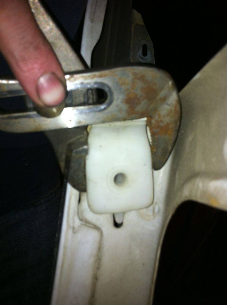

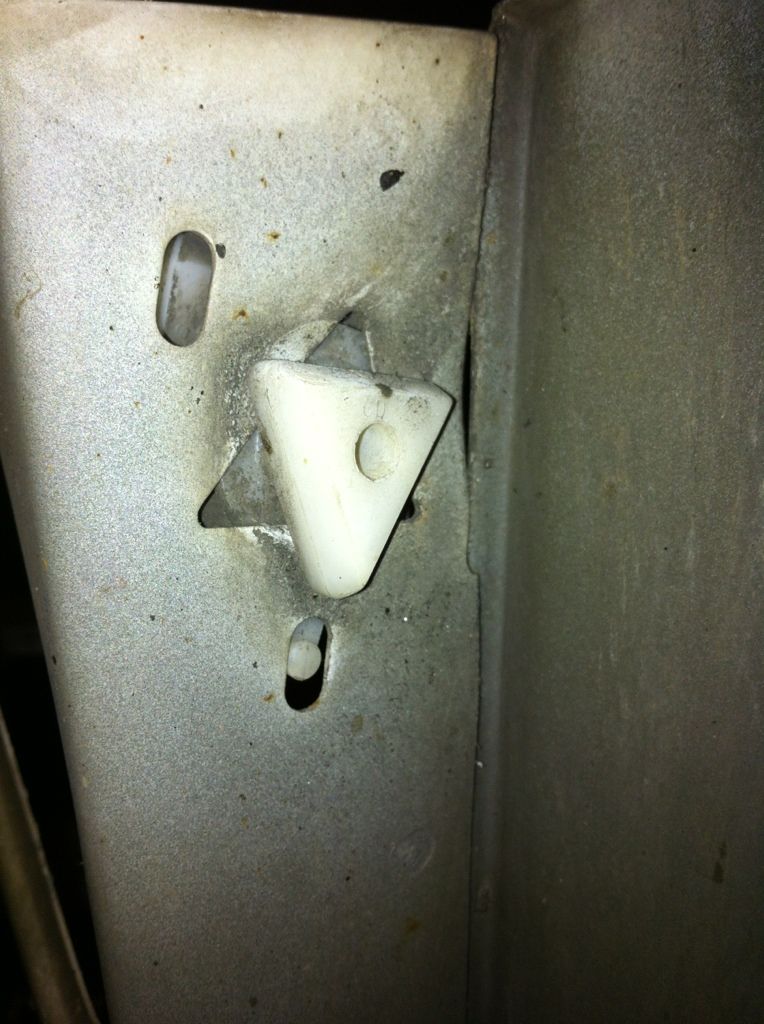

    Okay, I just messed around with it on my old fender. I should look like this
    You just have to take some channel locks to the bottom of it
    Then spin it to fit the triangle hole and watch out for the little locking clip
