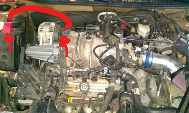

    Has anyone with the slow windows here done the Alternator rewire trick? After I did the Alt rewire thing my windows went up way faster on my 97 GT and my current 98 GTP. Just wondering.

    Copperas Cove, TEXAS
    5,981
    Quote Originally Posted by LS1GTP View Post
    My windows aren't slow, the motor is just messed up. But now that you mention it, I should do the big 3 upgrade.

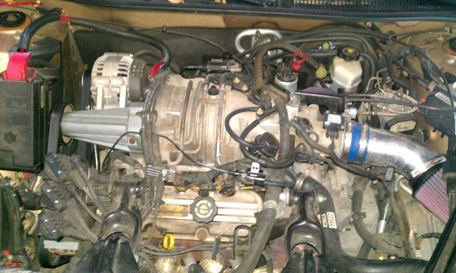

    Well, I have not done the big three, just the big one LOL, Ran a 4 gauge wire from behind the Alt to the top of the positive mount, made a huge change throughout the car.
    The 4 gauge wire was a 4ft or 5ft piece from the parts store for $5. You can run whatever gauge bigger, but 4 gauge worked for me.
    Here is were I ran it.
    Can kinda see it here, I have loom over it. The drawing above is for reference.
