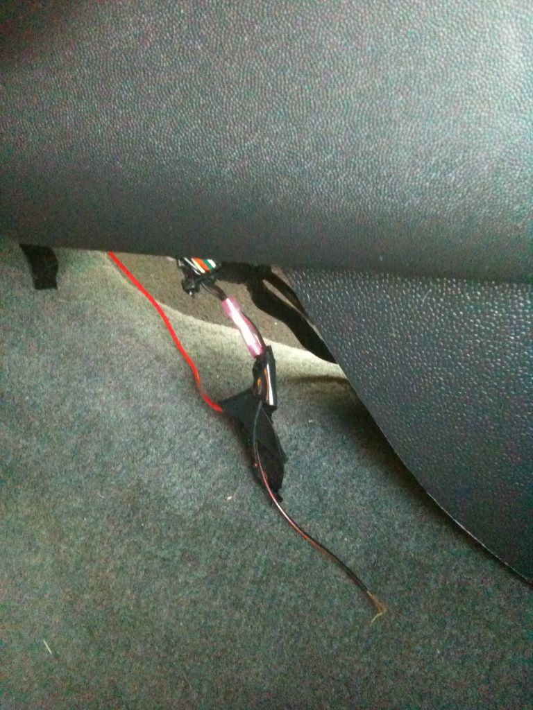

    What is this mess under my center console?

  9. #9 Re: I have 3 codes suddenly..
    What do you mean you were wrong about this post?
    Fix that crap!
  10. #10 Re: I have 3 codes suddenly..
    Pennsylvania
    915
    8
    13
    I meant specifically post #7 lol, that wire mess I just discovered coming out from near the onstar box. It it's not attached to anything I can see
