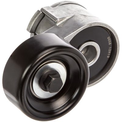

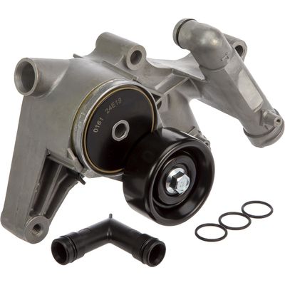

    in this pic. this is a sc tensioner you see the 3 marks in the black part, there are more marks on the body of it, when the belts on the marks should be close. or in the middle.
    this one is the accessory belt tensioner. i dont see the marks in this pic but should be similar.

    found this in my car pics the belt is off but the marks are clear on the s/c tensioner.
