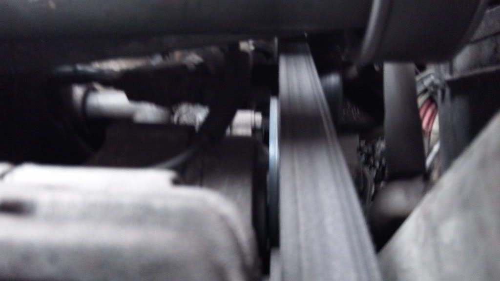

    in your pic here. wtf is that thing under the snout, by the belt, with the blue line off it, the vac line looks to be pulled towards it?

  11. #11 Re: Throttle blip
    SE Level Member Special K's Avatar
    Aug 2012
    Western NC
    108
    Not the best pics sorry. The line runs through it. It connect to that piece and another line runs to where the T should be

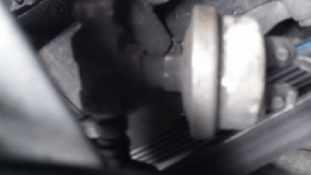

    I havent a clue but Ill have a pic up in a few minutes
  13. #13 Re: Throttle blip
    Aug 2012
    Western NC
    108
    Anybody know what i got going on w/ that thing? I guess im getting the vac hose kit off ebay unless someone knows where to get the whole kit for cheaper

    I cant make anything out in those pics
  15. #15 Re: Throttle blip

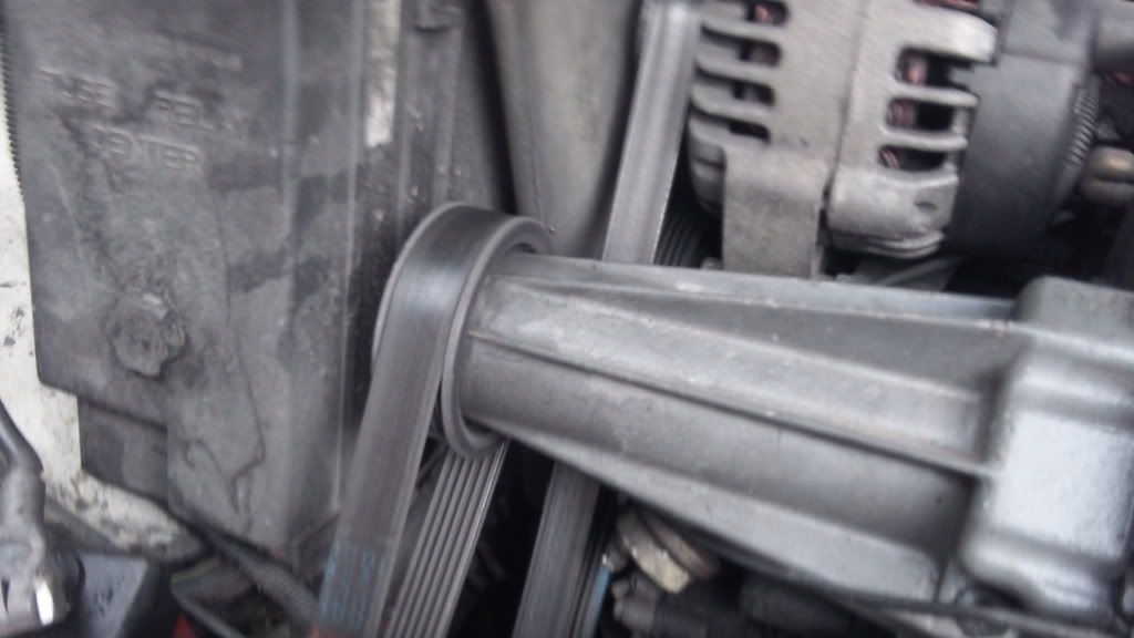

    whats this round thing in this pic by the belt? the only thing kinda shinny lol i know i dont have one.

    Yeah thats what im wondering.
  18. #18 Re: Throttle blip
    where does that plumbing go to? are those 2 wires at the top of it? looks like a sensor.

    The blue wire is cut

    I'll explain it the best way i can. Instead of the tee on the side of the engine (like in your pic), Its all one piece. That thing is whats being used for the vac hose adapter. Looks like a normal T between the hoses just has that thing coming off it. (just went out and looked at it)
