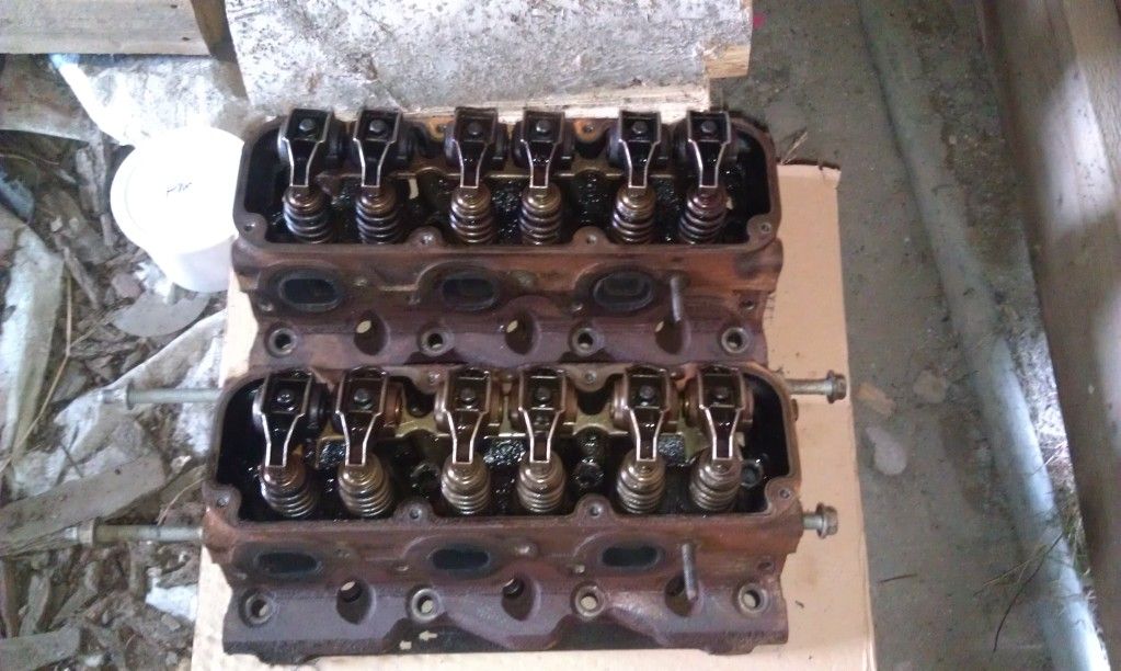

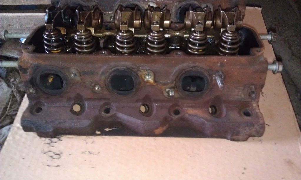

    Went out and snapped a few pictures of what they look like (for better clarification)
  7. #7 Re: Best and Easiest Way to Clean a Cylinder Head
    Why don't you have a gallon of superclean yet?

  9. #9 Re: Best and Easiest Way to Clean a Cylinder Head
    That's the stuff. They also sell the gallon jug.
    Might want to hit the outside with a wheel first.
