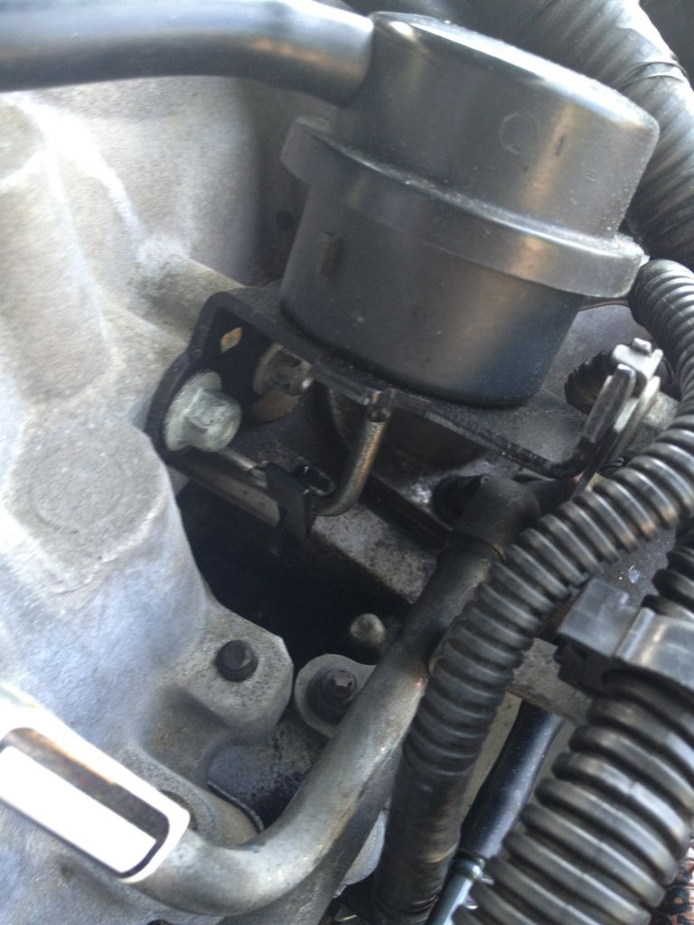

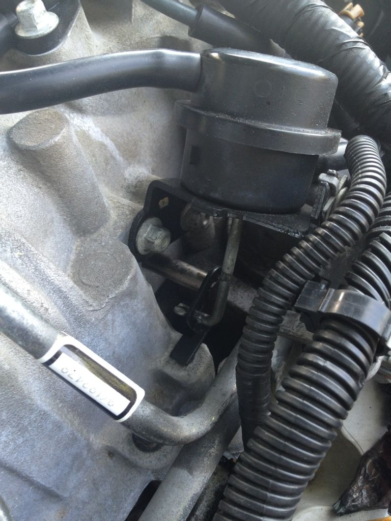

    Ok plugs are correct, tried carb cleaner no idle changes. I have a question though does the shaft for the bbv disappear Into the bbv or does it stick out halfway at idle? Mines doesn't fully retract into the bbv here is a pic
    This is how it sits with the car off
  18. #18 Re: BBV blocking boost?
    that's right. the butterfly is open at idle. if you rev it you should see it move down a little, but not fully close.
    it'll only fully close once you actually get into boost.
