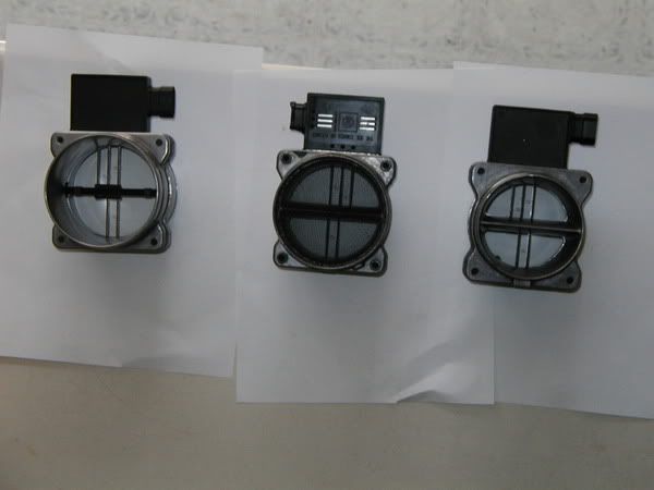

  18. #18 Re: Start up issue on 04 GT have to tap gas to keep it running
    TB: http://i1109.photobucket.com/albums/...0/IMG_2256.jpg
    MAF: http://i4.photobucket.com/albums/y13...a/P1010079.jpg
    Clean the TB with some brake clean and a towel you don't care about.
    MAF, use electrical cleaner.
