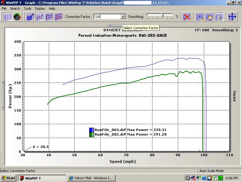

Got on the dyno today and put down numbers that weren't bad... but not everything I wanted.
The blue line is the 3rd/final/best run from today, the green line is the best pull on the M90 in both SAE and STD correction factors.
Some details about the dyno runs today...
The guy who owns the shop went out of his way to get me on there today. He's got paying customers waiting for me and I wasn't paying for the runs.
RPM pickup wasn't working, I still haven't had a lot of time to nail down the tune... Anyway, the first pull the tires were still wet and the car was straight off the highway. It spun the tires on the dyno and made 327. We ran dyno #2 about 5 minutes later, the tires didn't spin but I wasn't able to adjust the tune, it made 334. Run 3 I bumped the timing up 2 degrees, still saw no knock and it made 339.xx. I jumped off after thaat. I wasn't able to compare the bigger pulley, or drop to a smaller pulley.
I'm happy with the numbers, I would have liked 350whp SAE today but it just wasn't going to happen in 3 pulls where one of them was botched. I picked up just about 17% peak power, and picked up an even 50whp during the entire pull, any point of the graph shows 50whp gains.
What's the bottom line? I spent under a grand and picked up 50whp on a tune that had almost no time into it. Had I gotten the chance to drop to the 2.7'' pulley and tune that I would have had no issue breaking 350whp SAE.
Smaller blower, more power.

im not overly impressed with the costower ratio made. i never said it wouldnt make more power. the blower is clearly better designed as a whole and will produce better numbers, but i just dont see the cost weighing out in the end. im really one to push the idea of new and different ways to make the power, but this one seems to be a step in the wrong direction based solely on the money.

You act like $3,000 in mods to make double the power of a stock car and basically have a 12 second car capable of 11s on the right tires is a bad thing... all while running 93 octane gas and keeping near stock drivability.
You guys crack me up. You'll say anything to try and detract from the fact that I was hated on so hard by the smart guys on this board who all said it wouldn't work, then they all said it wouldn't make good power, now they're all saying what a GenV swap costs 2 years ago isn't worth 4x the gains of a GenV swap today.

276~ = gen3
291 = genV +5% increase
339 = tvs 1320 +23% increase
tvs 1650 = ????
