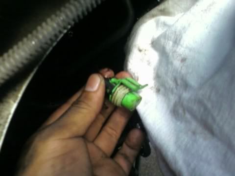

    well the sensor is messed up i think,oil comes out of it. not the other part.
    can i buy it new? or how do i replace this part?

    The connector in that picture......would still be fine.
    the internals of the sending unit itself blew out. a new sending unit is around 30 bucks...or less.
    just put sealer on the threads and screw it back into the housing. and reconnect the connector.
    you should be good to go.

    Quote Originally Posted by UR LOSN View Post
    What he said...
    It is the oil pressure sensor that is bad. Not the wiring connector.
    Buy a new sensor then in that case, and replace it.

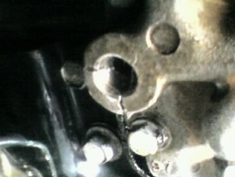

    ok well i found why its leaking on the sides now.
    it has to crack running along the inside.
    ok well i saw that u can probably replace this big part? but you would have to take lots of things apart.
    is that so??

    Quote Originally Posted by TDCRacing View Post
    Oil filter housing would be the name. Havent had any problems with mine leaking but here is a link to the gasket you would need if it ended up being the problem
    ZZ Performance
    Looks like you tightened it too much and cracked the aluminum housing. Pretty much all you need to do is snug it up once you put the tape around the threads of the sending unit.
    You will have to take the 2 bolts that hold the oil filter housing off and buy a gasket and a new oil filter housing. Look for the housing in a junk yard and you can purchase the gasket from the link in the above quote.

    Quote Originally Posted by TMOTA503 View Post
    is that so??
    I would either hit up your local junk yard or contact Ed for a replacement elbow.
    moradpartscompany.com
    I have one here on a spare engine I would sell you if you don't have any luck.
    Simple bolt on replacement. If you can remove the old one, and clean the old gasket off, and degrease the mating surfaces well, then the installment is simple as pie.
