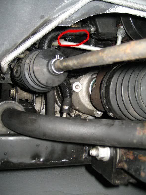

    ok well i refilled it with about 1/3 of a quart i had laying around. i filled it and it came out this piece i tool the pix from [GR8racingfool]
    i have a cell for camera since my family has the digi camera on vacation.anyways this is were the oil is coming from

    wondering if theres any easy way to clean it and repair it without doing lots of stuff[im 17 and with not much cash] dont have lots of tools either gonna go buy later a tool set.
    thanks
  10. #30 Re: Motor Oil Leak!
    Barksdale AFB, LA
    4,879
    That's the oil pressure sender. Seems you need a new one...

    hmmm... is it leaking from the sensor itself?

    Not at all saying it can't happen but I have personally never seen a sensor break like that. When the oil is dripping see if it is comming out of the actual sensor or if it is comming out of where the sensor screws into at.

    i say where it screws onto.

    You say or you know? Make sure the fitting is tight also. Take it out unplug the connector clean it , inspect it and reasemble
