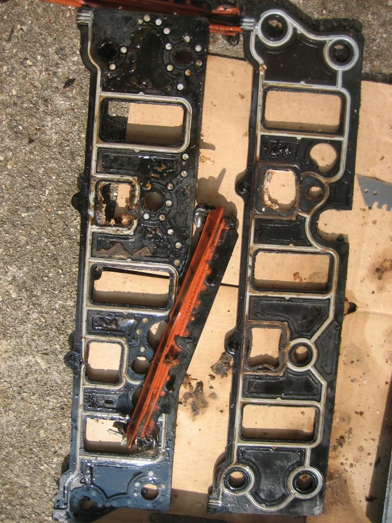

    So I decided to get off my ass and tackle this... among other things. Remember this=http://www.grandprixforums.net/f81/missing-anything-maintenance-related-kinda-long-31336.html

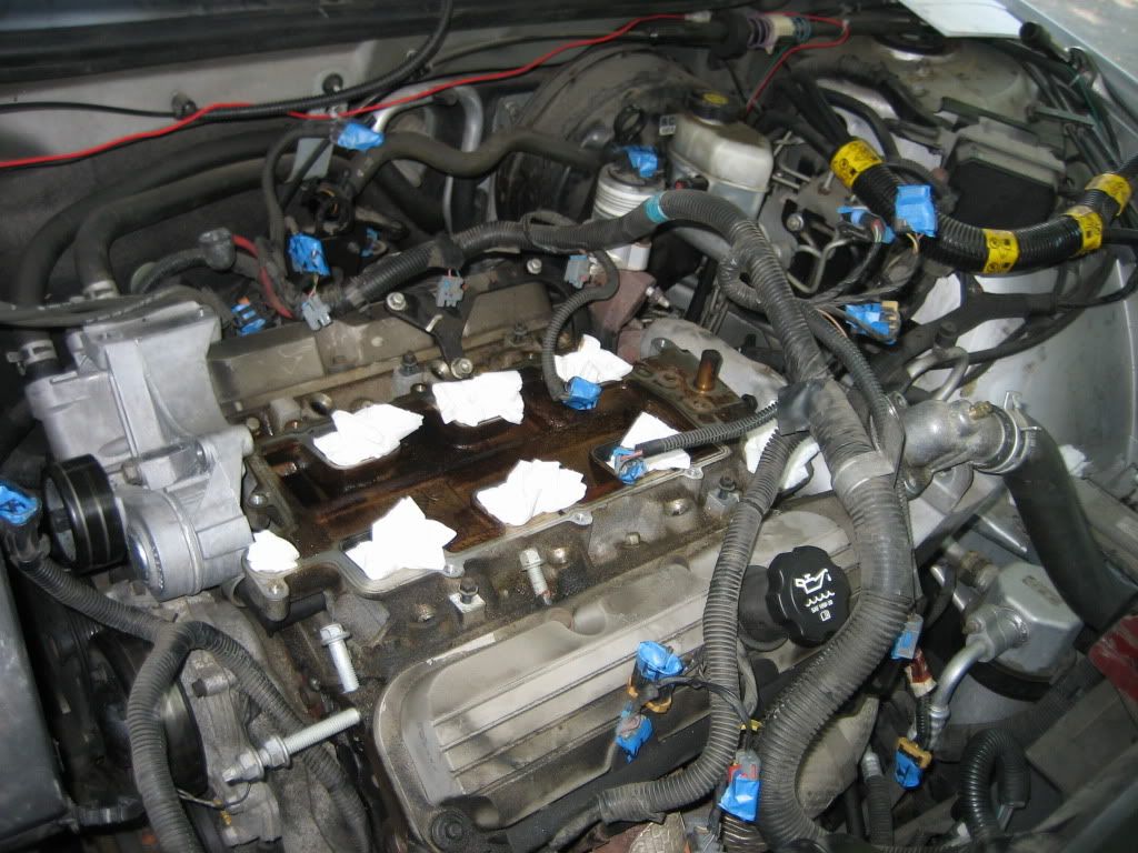

    About three hours into it.... and totally taking my time. Had already drained coolant and flushed twice, which takes for ever for cool down. Kinda neat once you see how its put together. Haven't really hit any snags, but I'm sure that happens at assembley. Cool thing is I am pretty much replacing almost everything that I'm removing.
    Just need to get valve covers off, tensioner bracket and LIM...... then the fun part!!!!
    as she sits...Im hungry... dont laugh at the tape!!!
    http://i162.photobucket.com/albums/t...0/IMG_0197.jpg
    oil on lim, pass side in back
    http://i162.photobucket.com/albums/t...0/IMG_0191.jpg

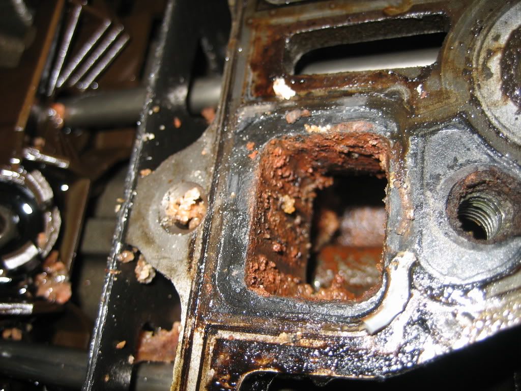

    the crap that came out of above pict, theres more in there, get it later.. but I found the bolt
    http://i162.photobucket.com/albums/t...0/IMG_0194.jpg

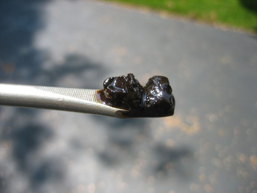

    123K miles, this is normanl isn't it? kinda forgot to seafoam before hand.. but I'll clean most of it off by hand
    http://i162.photobucket.com/albums/t...0/IMG_0189.jpg

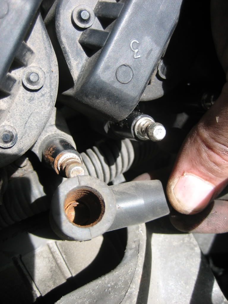

    this woulda caused some problems, and I wiped most of the rust away from the post
    http://i162.photobucket.com/albums/t...0/IMG_0178.jpg

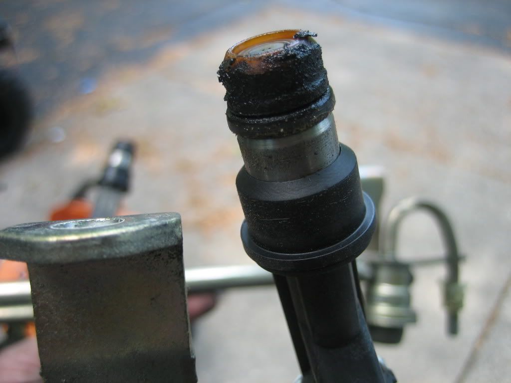

    I thought there were 2 o-rings on the injectors
    http://i162.photobucket.com/albums/t...0/IMG_0181.jpg
    post more later.

    Looks like I caught it in time.... didn't notice any coolant loss though??
    http://i162.photobucket.com/albums/t...0/IMG_0202.jpg

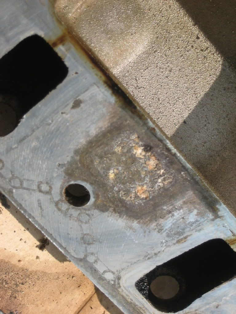

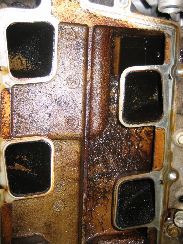

    How do you get the non-flowing coolant port clean?
    http://i162.photobucket.com/albums/t...0/IMG_0204.jpg
    This one was completly plugged with what looked like orange wax.... spent about an hour cleaning it out/off the valley.
    http://i162.photobucket.com/albums/t...0/IMG_0201.jpg
    I stopped beacuase it sounded like a big as storm coming in... but its just alot of noise. To late, already took a shower.... and its miller time (Becks and Pacifico Clara actually)!!!!
