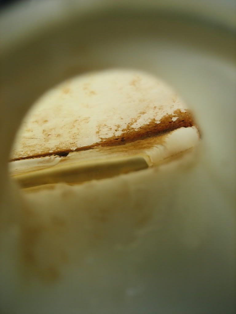

    I am doing car work and was wondering how to get this dexcool residue off of the insides of the overflow tank. I've run plenty of water through it already. And shook the crap out of it, but this stuff on the sides wont budge!!
    Can I just spray some brake parts cleaner in there?
    tank
    http://i162.photobucket.com/albums/t...0/IMG_0174.jpg

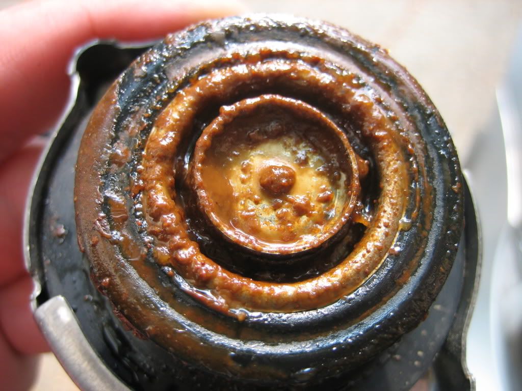

    rad cap, yummy!!
    http://i162.photobucket.com/albums/t...0/IMG_0173.jpg

    buy a new one dude. i tried everything to clean mine. its literally impossible without cutting it open, scrubbing it with a wire brush, then putting it back together. you wont clean it.

    ok since noone has posted,
    take a old rag, soak it with brake clean, stuff the rag in the overflow, and shake the crap out if it. then the corners, a long screwdriver or whatever will clear up the rest.
    i have done this on many cars to get the bottle looking new again

    ^X2. I just did mine this past weekend. Stuff a rag in it, spray the sh*t out of it with brake cleaner and use a long screwdriver and then a coat hanger to get around the center piece. Then rinse with water. Works like a charm...
