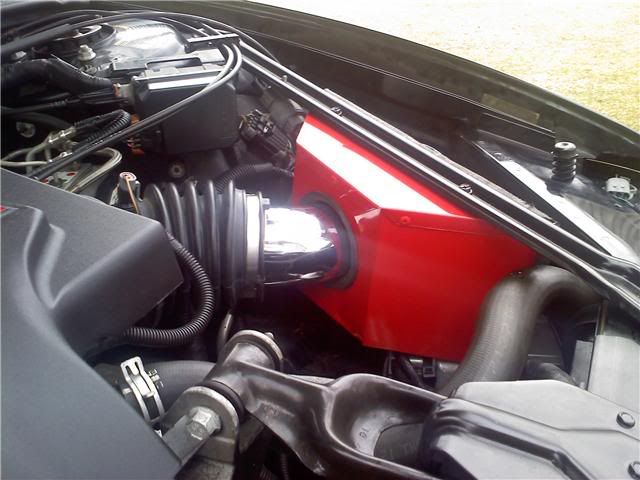

This is what I made and it seems to work great. the other end is completely open. its made of aluminum to "disperse" heat quicker. probly doesnt make a difference. but i feel better with some sort of heat shield.http://i268.photobucket.com/albums/j...e5/utmsyrn.jpg
Why did you not get rid of the restrictive part of the intake?
you should have taken out the part of the intake that was restrictive. that corrugated tubing is your problem, not the air box.
If we build our own intake out of PVC and create a heat shield similar to colindunn, what size k&n is best? 9"?
I would suggest using the stock airbox for the heat shield and PVC or Aluminum for the tubing. The stock box with a K&N cone filter will flow more air than even the M90 engine needs and supply the required heat shield. With most modifications.

Well I ran the open cone for a few days and it's defenitely doing more KR with my setup. I don't have a KR scanner, but it's doing that thing again where it has more power at 90% throttle than it does at WOT.
I'll put back my home made intake later on, but the MAF screen got torn to pieces when I took it off LoL.
