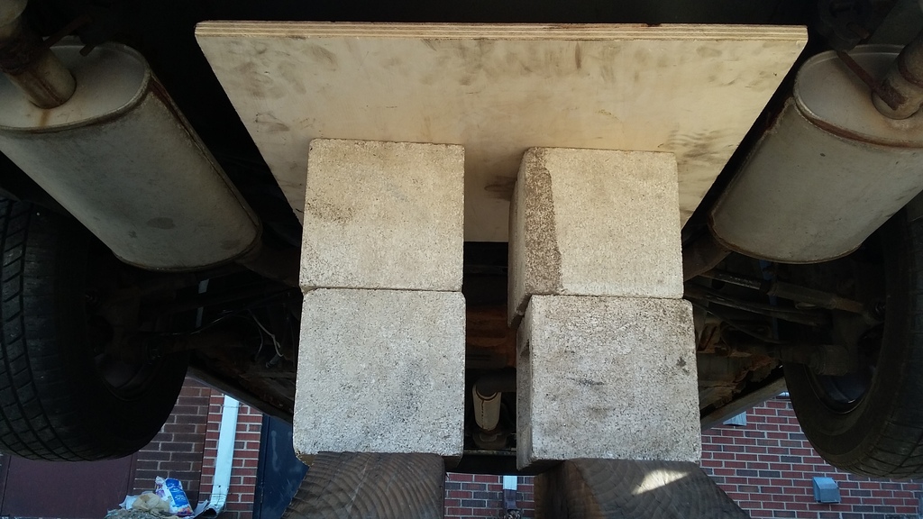

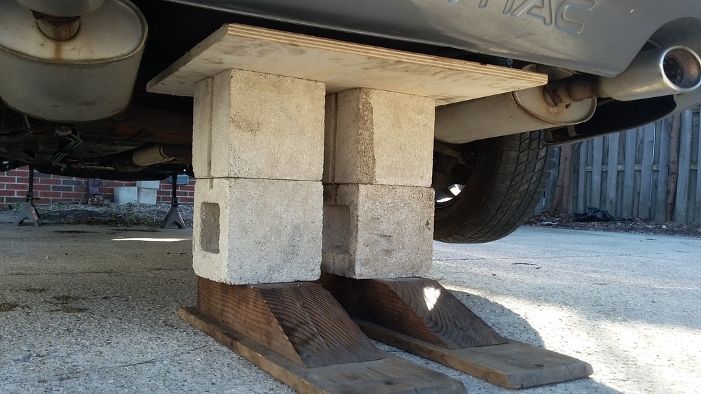

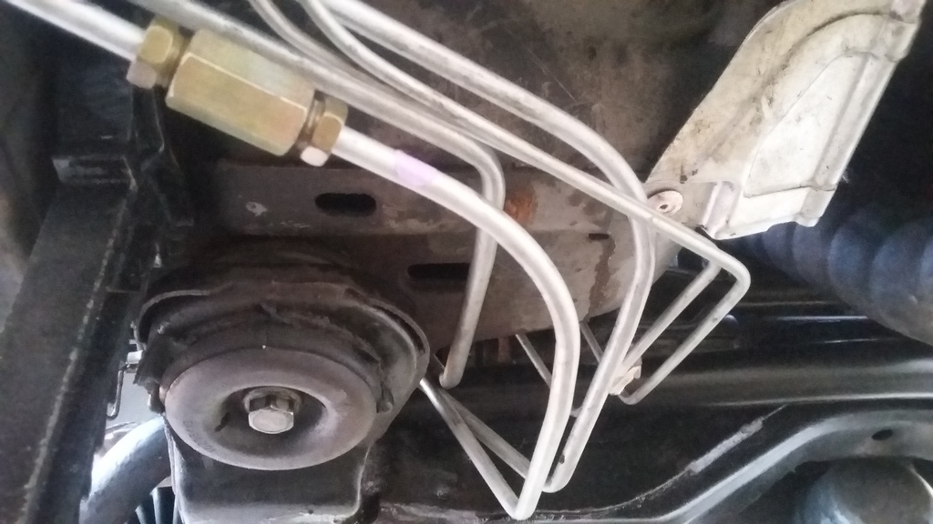

    The setup below worked for me. The jackstands are on the subframe in the first pic. But, in the last pic with the fuel lines, you can see the head of the jackstand just south of the subframe connection. That's a good spot for the front! Had my car in the air with that setup for months and months. It withstood gale force winds, torrential rain, etc.
