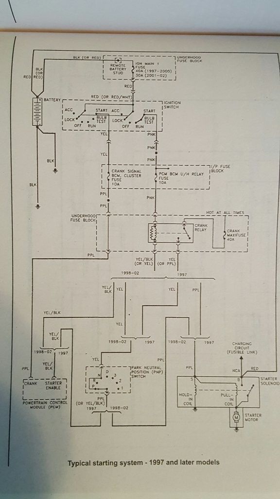

2005 dash mounted ignition switch. Key is stuck in acc mode. Engine will start and run... shifter isn't stuck in park. Have dash torn apart. Can't get radio out because the trim won't flex enough and can't remove it because with the key stuck, I can't remove the off -acc-run- start bezel. Center console removed. Lock cable looks good. Have removed the shift lock cable from the back of the ignition switch thinking that there is something in there I can push with a small screw driver. Looking inside with a mirror, I can't see what the cable pushes on...
