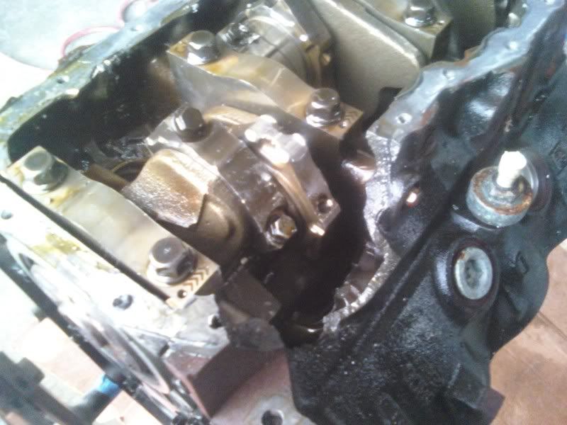

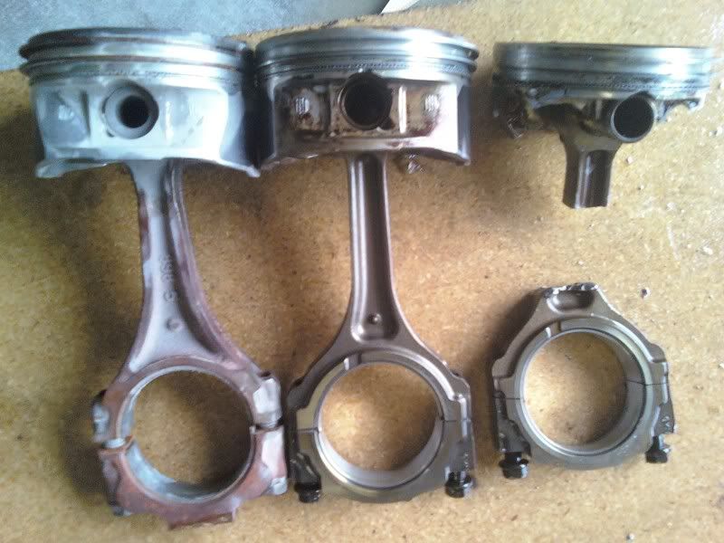

    L36 bottom end would hold just fine. Stay away from the L26 if you want that much power or you will end up with this.
    This is a side by side comparison of the l36 and l67 connecting rod. L67 on top L36 on bottom.
    And L26
    And L26
    L36 is stronger than the newer L26? I thought it was reverse. IIRC the rods were skinnier in the L26 but made of a stronger metal...
    Scotty, I want my L36 back.......
    From my understanding powdered metal sucks for connecting rods. Especially when they look like toothpicks.
