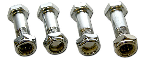

I didn't want to wait for a replacement bushing to arrive, and my lever was pretty rusted. Instead I ground down the back of the lever and popped out the shift lever pin. I cleaned out the cable with a 5/16 drill bit by hand, and used a clevis bolt and washer. I greased it and made sure everything moved freely. I attached the nut and bolt to the end of the shift cable in the open where it was easy to work. Then I re-attached the shift lever to the transmission. Finally I re-attached the shift cable bracket.
Here's what a clevis bolt looks like. http://www.est1946.com/ProductImages...evis_bolts.jpg
