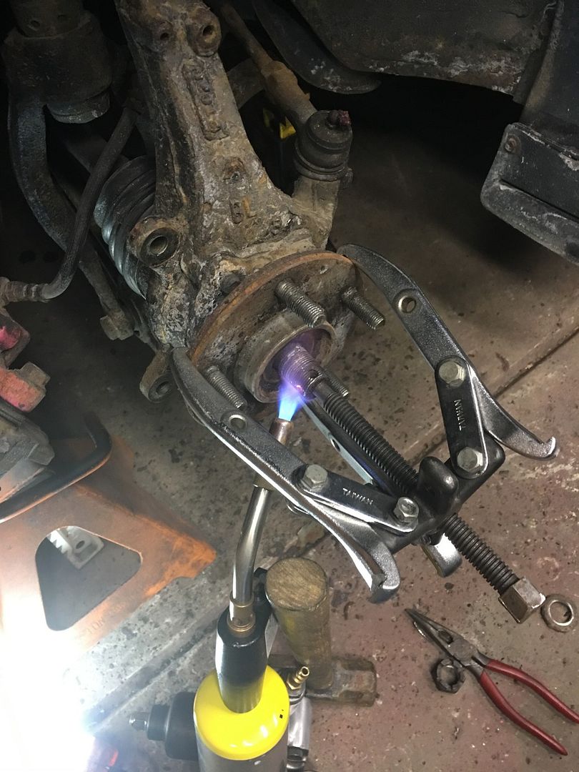

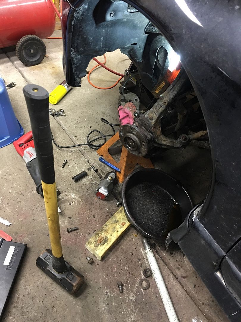

155k original bearing and axle.
Big ass hammer. 3 jaw puller. Map gas.
winner
sawzall and 3 blades

You got all the studs out without removing the hub? WTF?!? I had a short stud and it still was too long.
Re: What did you do to your Car today? Vol 2.0
Yup. Whack it and rotate it Left and right sides of the knuckle are narrow
and you have to remove the lower control arm to remove the axle as it sits between the lower strut fork.
Just an annoying day for my beater car. 2 wheel bearings and 1 axle later. Scrapped the idea of replacing both. The passenger side is solid. But if it went smoother on the driver side , I was going to do both.
Using discounts I got both bearings for $30
but it cost me $65 for the axle minus 30% off at advance auto
so I'm not attempting the passenger side unless needed.
The driver side was soo bad the rim was actually clanking around like the lugs were loose

That's what I read, but me and a buddy tried and tried and tried; just wan't going to clear. The only reason the old one came out is cuz it was broken. The new Raybestos one was short for easy install. Ya right. Had to pop the bearing off to get her done.
