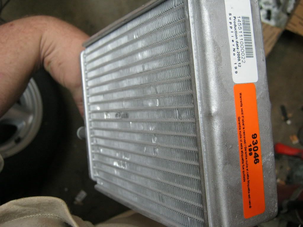

    If it is a zzp one it is from a 95 ford probe
    Spectra Premium 93046 is the part number.
