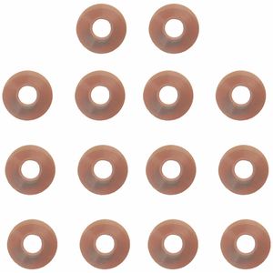

    also i notice in picture the valve cover grommets were blue i been seeing alot of those on the internet but when i look up the felpro brand they are not blue so are those blue ones some special ones or some sort
  8. #8 Re: impala 3.8 gaskets replace
    my fel pros were blue.
    lifter swap is no big deal if your doing a lim job and valve cover gaskets already.

    these are the felpro ones i see for my car i didnt see the blues

    when you buy the valve cover gaskets they should come with new grommets.
