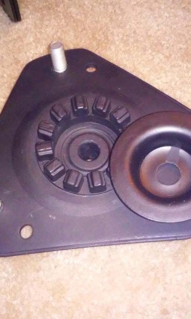

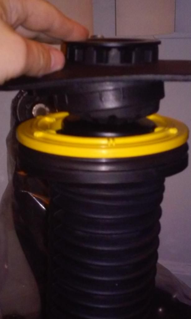

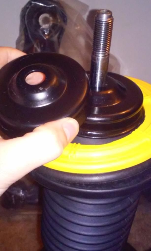

    So I ordered KYB struts, mount kit & boot and went with Moog coil springs. I plan on doing a complete swap not using any of the old parts from old suspension. I didnt realize at the time of ordering that the strut mount kit did not come with the lower coil insulator so I just ordered them tonight from rockauto because AutoZone is way over priced... $10ea on rockauto for KYB insulator and $20ea at AutoZone. So while i'm waiting I figured I would get all the parts in order minus the coil spring. Im a little confused on were these 2 parts go and not sure if they are in the correct order so if any of you guys know if its in right order or not let me know! I got a small instruction paper but it doesn't show where all parts go...
    Heres the pics!
    Why I am asking is because the order I have it in, I can put the top bolt on because not enough thread is showing.

    You need a spring compressor
    edit>> derp no spring, gonna need one anyway
    Pull up on the strut shaft

    I know I will need a spring compressor but I thought maybe I had the parts in the wrong order, I take it they are in right order?

    These 2 pieces go together like this?
    Like this
    I did see that forum but was confused on those 2 pieces.
  6. #6 Re: Strut assemble question "with pics"!!!
    You need to look at the struts currently on your car.
    Those two pieces don't go together at all.

    On my gp it only shows that flat piece that is in the picture. If you look at that thread that was posted it shows the bowl piece and then in another picture i t shows a flat piece on the top of the strut.

    Here you go!

    Now what about that bowl looking puece i have on the top of my strut high octane?

    if you look closely to your old mount, you'll see that bowl piece isn't used

    Quote Originally Posted by CyxRyan View Post
    That bowl snaps over the top of the bump stop, bowl side down.
    EDIT: Keeps the strut bearing or mount from rubbing the foam bump stop.

    The guy that used it in this link, http://www.gpona.com/forums/step-by-...-s-t12932.html, SHOULDN'T have used that piece. IIRC that bowl piece is for another vehicle like the Pontiac Aztek or Pontiac Montana and those vehicles use the same strut mounts as Grand Prixs. The manufacturer just threw that piece in there for which ever vehicle uses it.

    This is what mine looks like
