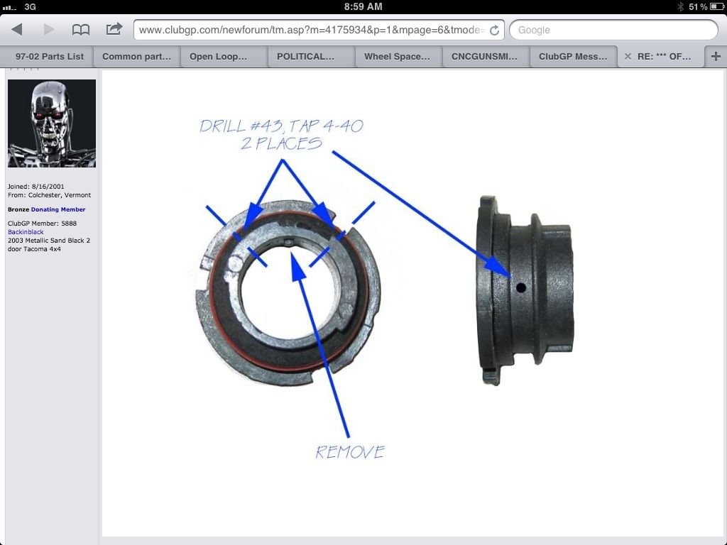

    I run HID's in the stock housing, no problem, no blinding people. Do a search, there is a mod you can do to the light socket that'll sit it back approx. 3/4" and place the lamp properly in the headlight so it throws the light just as the stock bulb does. If you don't do the mod, then just get the single lamp (no high beam), because then it doesn't matter.

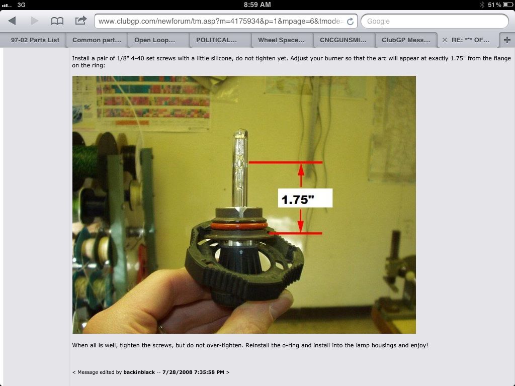

    I have the pics, it was not my thread but I saved the pics, will try to post them up later. Basically, you want the part of the filament that lights/burns to be inserted the same depth into the headlight housings. The original write up showed how to drill 2 or 3 small holes in the housing where the lamp twists in, using small Allen type screws to lock the lamp in at the correct depth. It's simple really...

    What I have...
    Original link: but pics are gone!
    http://www.clubgp.com/newforum/tm.as...mode=1&smode=1

    Does that basically just modify the retaining collar thing the bulb twists into so it sits back more? Other thing i question is do those bulbs just tilt or do they telescope back and forth? Seems simple enough tho.
