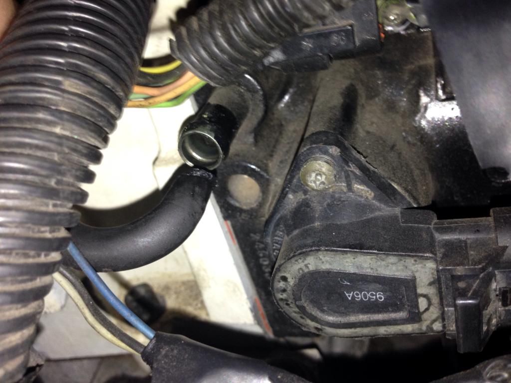

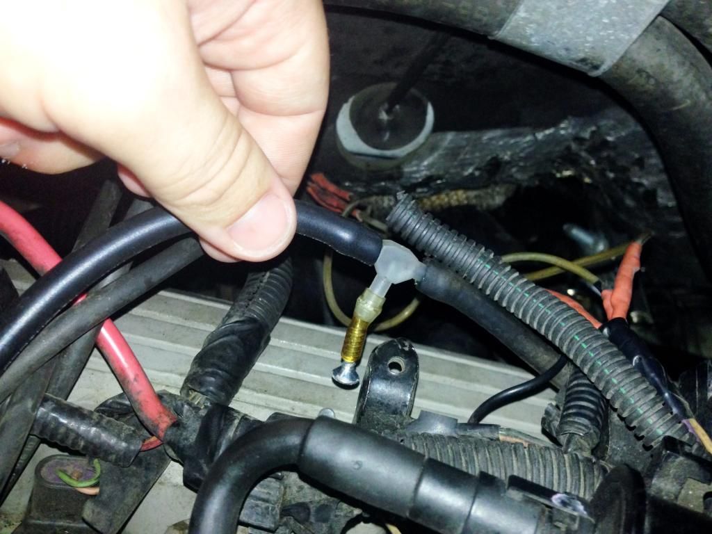

    Well, I started checking vac lines beginning with the T under the s/c about like you said. The lines on that T weren't pushed on all the way and were brittle. Replaced them all with new vac hose. Then, I look at the T fitting between the engine and the firewall and I see this....where is the capped off line supposed to go to? Anywhere?
    Then, this hose connecting to the throttle body is too small for the nipple so the previous owner just connected it with electrical tape

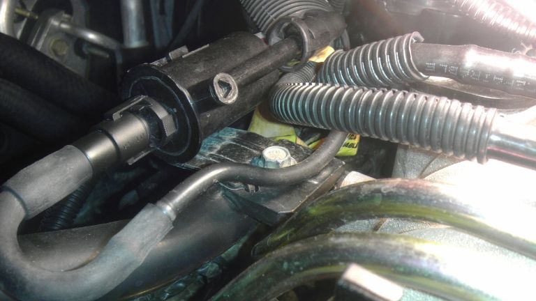

    This thing I'm holding (don't know what it is) isn't bolted down anywhere, just left loose!

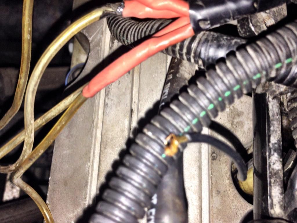

    aaaaaaand to top it all off, I have a random loose wire coming out of the backside of the engine and I don't know what's it's for or where it's even supposed to be connected.
    This poor car needs some SERIOUS attention!!!
    I had to replace that hose almost immediately after buying my car also. Can't remember what I was doing, but I just bumped it, and it seemed to turn into dust. The plastic and rubber out here gets so brittle.
    Anyhow that hose is GM Part: 24506665.

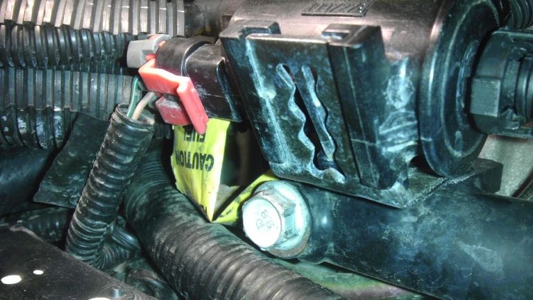

    I took care of this one today. Was able to cobble together hoses from the scrap pile at autozone to hook everything up. Now I just need to figure out what's going on with the other pics I posted on the rear of the engine (stray wire, Evap purge solenoid that's not secured, and T fitting that has one end blocked off.

    Hell yeah! That would be awesome. I just figured out that the T in vacuum line on the back of the engine isn't supposed to be there, so I replaced that with a straight hose to the MAP sensor.
    The last two things I still haven't been able to figure out are how to mount the evap purge solenoid and also what the exposed black wire (seems to be coming out of the injector for cylinder 4) is supposed to be for. If you posted reference pics that help me figure both of those issues out that would be AWESOME!

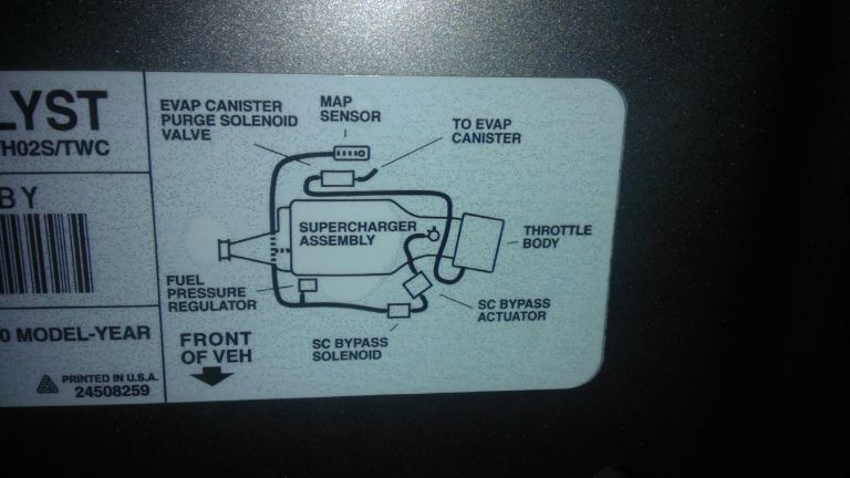

    Okay... From what I can tell, you're missing the small bracket that the purge solenoid mounts to:
    As for the wire coming from the #4 injector... All I can tell you is, mine doesn't have that. All 6 injectors are identical.
    And my vac lines follow the under hood sticker, verbatim.
    Just looks like someone replaced the hard line with hose.

    [QUOTE=BrandonHall10;1277629]Okay... From what I can tell, you're missing the small bracket that the purge solenoid mounts to:
    /QUOTE]
    It looks like I'm missing that black metal rod that the solenoid bolts down onto. The rod connects on the other end to the alternator I think. I'll have to hit a junkyard to see if I can find that. Thanks!!!

    No problem. Haha! I didn't even notice the rod was missing. Ya, it runs from the back of the sc to the alternator.

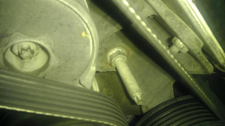

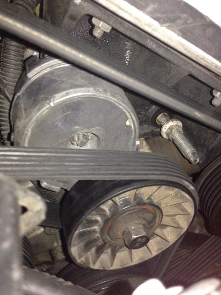

    Ok Brandon, I have one more pic that I hope you can reference from your car. The long bolt in this picture sticking out of the block, what is supposed to be here because this bolt certainly looks out of place. For reference, the large pulley in the pic is the belt tensioner for the supercharger.

    146
    Same here;
    Only mine is tight!
    I would like to know why GM used such a long dong stud there. I assume there's a reason. (?)

    Hmm weird. Hopefully someone will pipe up and tell us the purpose of the damn thing. In the meantime, thank you for letting me know I'm safe to screw that nut down tight!
