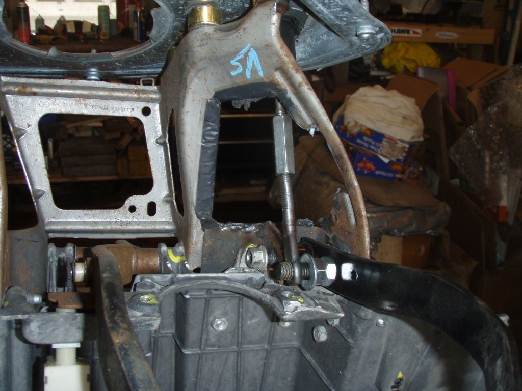

    That's actually not true. It's made of metal, not plastic. It may not be magnesium, although when I modified mine to make a bracket for a clutch pedal, was welding near some of its shavings and they flared up. It was advertised as having "Mag-Beam" construction. I've had my Impala down to the unibody twice now, and I can tell you the dash structure is not made of plastic. Look at the first picture I posted.

    that first picture shows the large glass reinforced ABS plastic dash structure.
    its molded around a thin steel frame that contains the nutserts that all the fasteners thread into.
    ive see burned impala's and that blackish/dark grey piece turns into a large sheet of glass fibers just like our valvecovers do
    there is a cast aluminum bracket near the colum pedestal/pedal assembly...aluminum flares up and is just as flammable as magnesium...but there is no way they made the plastic crash structure out of magnesium, no way they would spend more $ on metal than necessary...plastic is easier to injecton mold than it is to die cast aluminum or much more flammable magnesium parts....
    plus its lighter....sooo we have cheaper, cheaper, cheaper, lighter vs heavier, $ materials, $$ manufacture process, weight
    what do you think GM went with
    your car may have "mag beam" construction but that would likely just be the cross dash support bar...but then again it could just be sales jargon
    like PM "forged" rods....sounds good....but amazing how brittle, and cheaper to make....but no real strength unlike the older/more expensive cast rods that bend and dont break/shatter.
    in reality, they did it cause it was cheaper/faster for the grunts on the line to snap **** together and shave 3 minutes of assembly time....
    sorry bud but that piece going across the dash is the newer style glass reinforced ABS plastic dash module, GM is using them nowadays over steel/alum...its cheaper and faster and lighter...

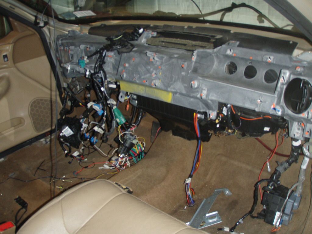

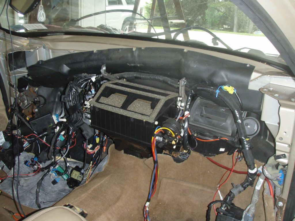

    There is no beam underneath the gray metal piece in the first picture. There is a molded plastic piece that bolts to it that the radio, cluster, etc bolts to, pictured in the other photos, but that black and not what I am referring to.
    The medal piece I'm talking about actually seconds as the brake pedal bracket, its what made it so much more work to fabricate a clutch pedal mount. I had to take the entire dash apart, unlike a grand prix where you can remove the brake pedal mount from the steel dash structure.
    This is what it looks like when you take the metal piece off, there's nothing underneath.
