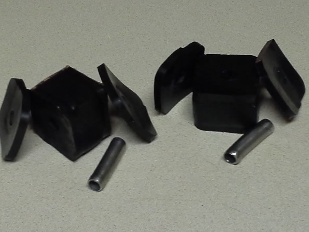

    Thought i'll show why I changed to the Intense mounts. Mind you these are only 2yrs old and my second pair.[IMG][/IMG][IMG][/IMG]
    If your heavily modded or have a decent amount of torque then this could happen. Im not heavily modded but I do drive hard. Hopefully these Intense mounts will do the trick. Its been about 3wks now with these Intense mounts and so far so good. Very firm and surprisenly less vibration then the 3800performance MSP mounts. Heres Intense mounts[IMG][/IMG]

    Notice the size difference of the bushings between Intense and MSP mounts. Major difference, and the bushings themselves alone of the Intense mounts tell you that they mean business...
    Hope this helps someone in making they're decision when buying upper square radiator support mounts.
    Thanks, Dee...
